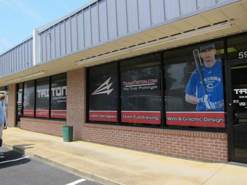

Laminated perfs just do not look good to me, at least gloss. I did a little somn different on a customer bout 2 years ago. i ordered the perf from signs365, got it in and lightly misted a few coats of automotive clearcoat on it. It still looks great today and its for a lawn dude and hes always out and about.
we also did this storefront 2.5 years ago and still holding up, it faces east so Im sure that helps, no laminate on it
