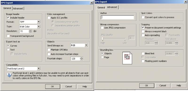

Are you using your old exported EPS files from your old Corel to bring back into Versaworks, or are you bringing in the CDR files and re-exporting them on the new machine?
If you're using old CDR files, the default EPS export settings may not work, and I believe I ran into that same issue before. I've attached my export dialog settings that I use on my production machine. Most important is that the EPS version be EPS Ver 2 (I believe my install went to 3 by default and was the initial cause of my problem). Hope that's the case and hope it gets you on your way.
I.E. I for example do all my design on my design machine, access the files from my versacamm/production machine and export to a "cut file" EPS which is saved on the versaworks machine. I don't think a lo tof people actually keep the EPS hanging around, but I do just in case as kind of a dual backup, or in case a job isn't coming out quite right.

Thanks again. I tried re saving them and also tired new file and nothing. Double checked the exporting and is version 2. Thanks for the ideas, If you think of anything else please let me know. Thanks again
