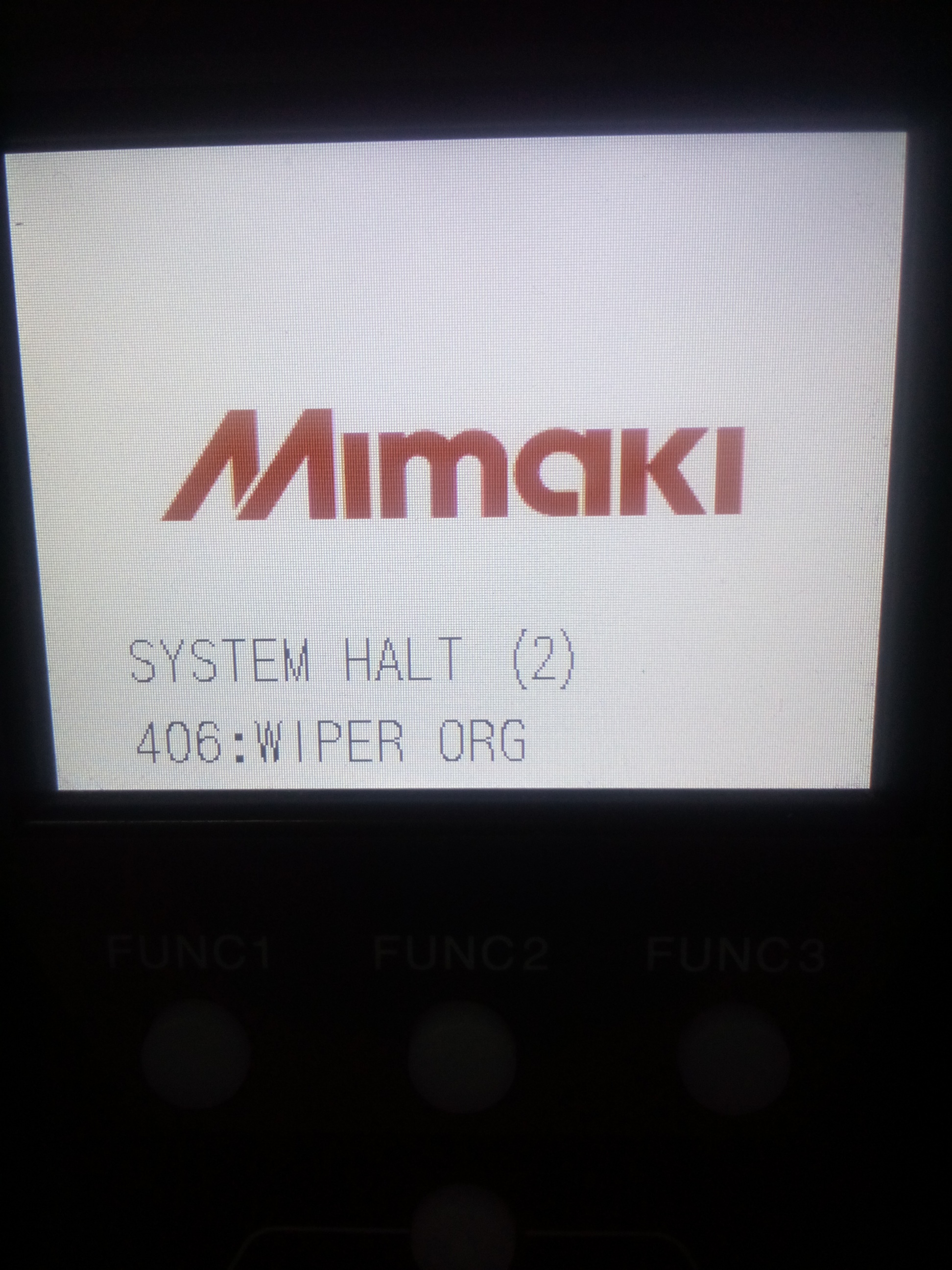

I have a CVJ-300-130 plus. Yesterday I was getting an error at startup. It was about the wiper. It made some kind of crazy sounds and would never get past the startup screen.
Today, I try it, and no error. Everything is fine except the wiper is still making clicking sounds but seems to be moving around good.

The slide part was fairly clean but i went ahead and cleaned it anyway. Now i got the error again. How can i move the head to apply grease? Its stuck on this screen

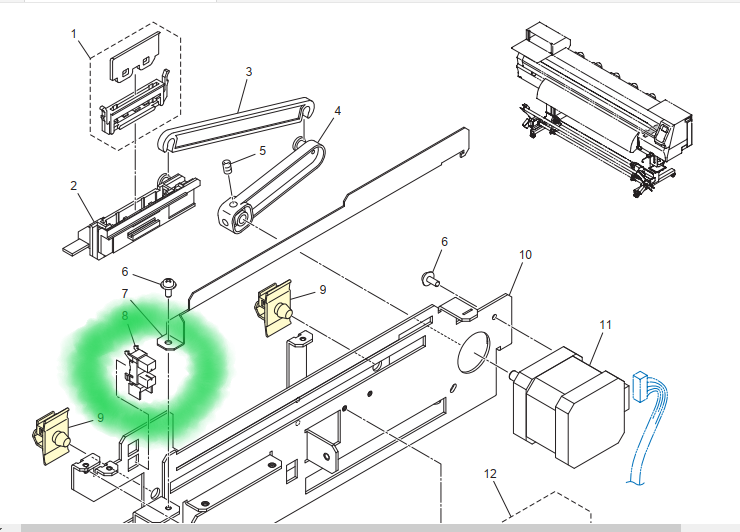

Yeah it's just not making it back to the origin. It's possible the motor is failing but that is very rare. You might try cleaning the sensor with some alcohol. Here's a picture of where that sensor is.

How do I get to it?
If you take the cover off that covers the pump and below the maintenance station I believe it will expose the wiper sensor. It's hard without a picture to point out but the cover sort of looks like a glove box. Should be like 3 screws and it will come off.

The sensor was free floating. I put it back in its spot. It still isnt working.
I am thinking I need a new sensor.
