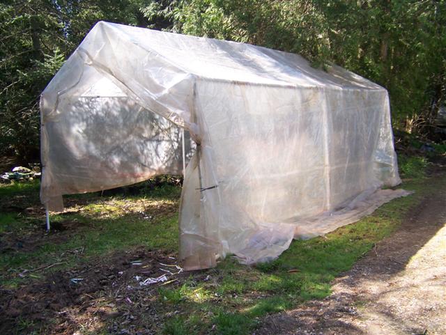

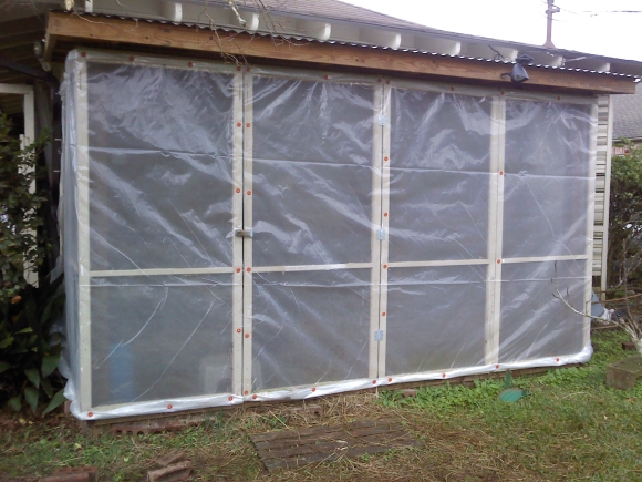

You say you do have "coverage", well if that is like a large carport, you could drape 4 mill clear plastic around all four sides leaving a overlap at one location for access. Get you a small 5000 btu air conditioner from Wally world for $139, and sit it on a chair next to the plastic, cut a hole in the 4 mill plastic around the small AC unit and seal it with duct tape, plug it into e 110v source and you will be good to go in about 15-30 minutes depending on the outside air temperature and how cool you set the thermostat on the AC unit.
Another plus, the positive air pressure will keep you new in-closed wrap area dust free!
