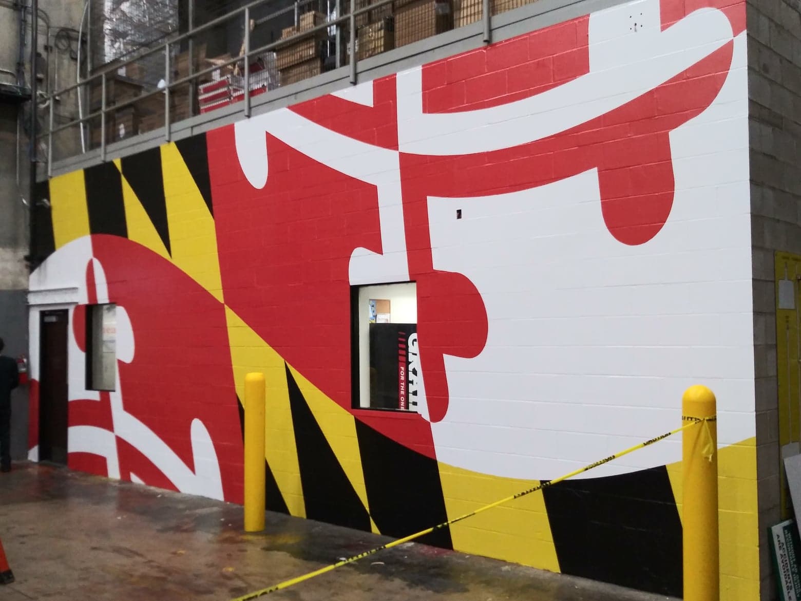

We just finished a job using Alumigraphics smooth. 34ft x 13 ft. We arent the fastest. took us 12 hours.

just did a job with the mactac rough rap. that stuff looks like paint on a wall when installed well. big fan. vinyl made for block and brick wall.
