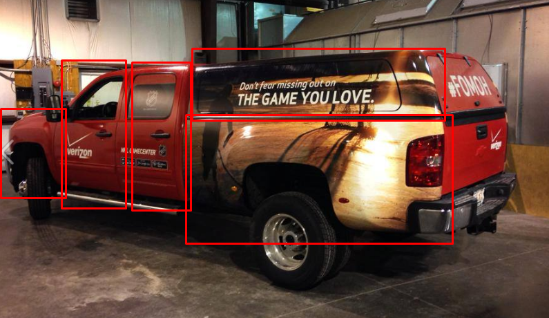

You can definitely do the fenders as one piece. I would recommend doing it as 1 piece so you don't need to fight with lining up tiles on a crazy curve like that. I've done 50-100 wraps on Ford & Chevy dually's. I've tiled them before, but it makes it ugly and ends up being a lot more work.
1.) Make sure you aren't using cheap wrap material. 3M IJ480 is prob. the easiest, but I always use 3M 180cV3 w/ 8518(19,20) lam.
2.) I would print the entire fender as one piece (see attached photo for tiling layout). I would print that panel @ 52"h or larger (need a lot of material for the curve)
3.) My installers would use two guys when possible (they would do it solo when needed, but easier with 2). One guy to heat and squeegee, the other guy simply to pull material flat.
4.) Text and logos would be done as spot logos on top of the wrap.
Let me know if you have any questions or need anything else.
Go Team!
