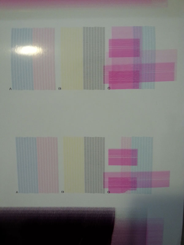

I restarted the printer (removed power cable) did various cleanings in addition to soaking the cap tops.

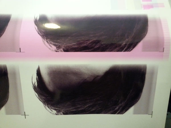

This is a first, I am trying to print a job and there is LM spray everywhere on the print with lines.

Forgive me if I'm wrong...But I'm pretty sure this means there is an issue with the head board, rather than the head itself.
In other words, I think the computer is getting confused. Your jet test looks pretty funky, it's almost as if it can't remember how to print one for magenta.
If you have tried swabbing the heads, a 48 hour soak, flushed the lines and replaced the caps...Then there isn't much else you can do apart from assume electrical fault or try a different head.
Does the pattern on the jet test change each time you run it? If it does, I guess it could still be severely misdirected nozzles...And when I say severely, I mean SEVERELY misdirected haha.
I'm thinking it might possibly be a print head cable, they look pretty worn out. I have never seen anything like this before...looks like LM is having Jack Daniels on the rocks in celebration of LDW 14 :bushmill:
Test prints are completely different every time but its showing lines...
Good point. I didn't think about the print head cables...After all, they connect to the head board and could be causing the problem. I do recall other members having issues with cables in the past which sorted the issue upon replacement. It's certainly cheaper than a new head in any case!
