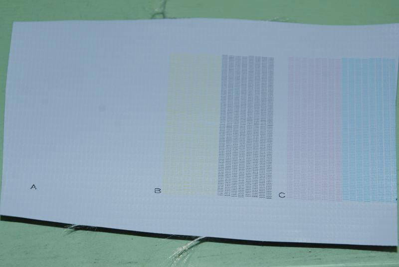

Group (a) does not print, is replacing pac.what to do?
CMYKLcLm is my print setting.
help me.
Robert M
Group
The the fuse on the main board for group A. Look for small fuses marked F1 , F2
I have a tech manual if you need it. Email me and mention which printer you have.
Gabriel
Robert is right
It's hard to belive that both cyan and magenta cap tops and dampers are broken :Oops:. So you have a problem with the fuse on the main board. If you need further information, just ask. I also have a service manual for XC 540.
