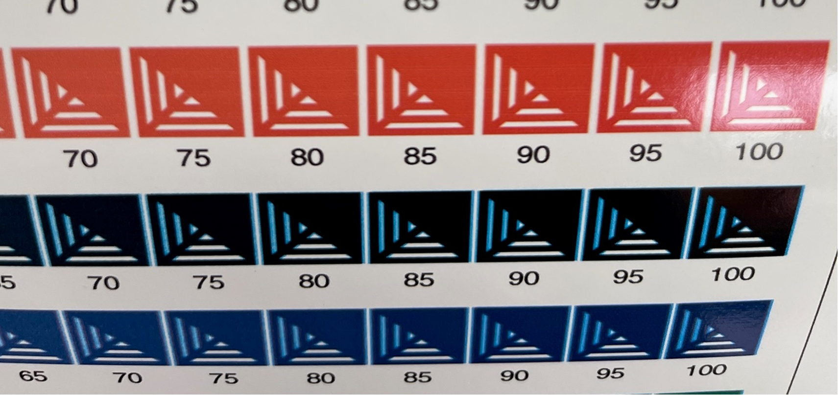

Any idea whats causing the Light Cyan colored over-spray for lack of a better description in the vertical areas, Happens with any colors that use Cyan as part of the color mix.
Does not matter if heavy saturation or very light
I have done all calibration and alignment checks everything seems good
Thank You

Post a nozzle test here. It could also be that the head got bumped out of alignment. A nozzle test can show a lot more than just the firing of the nozzles.
