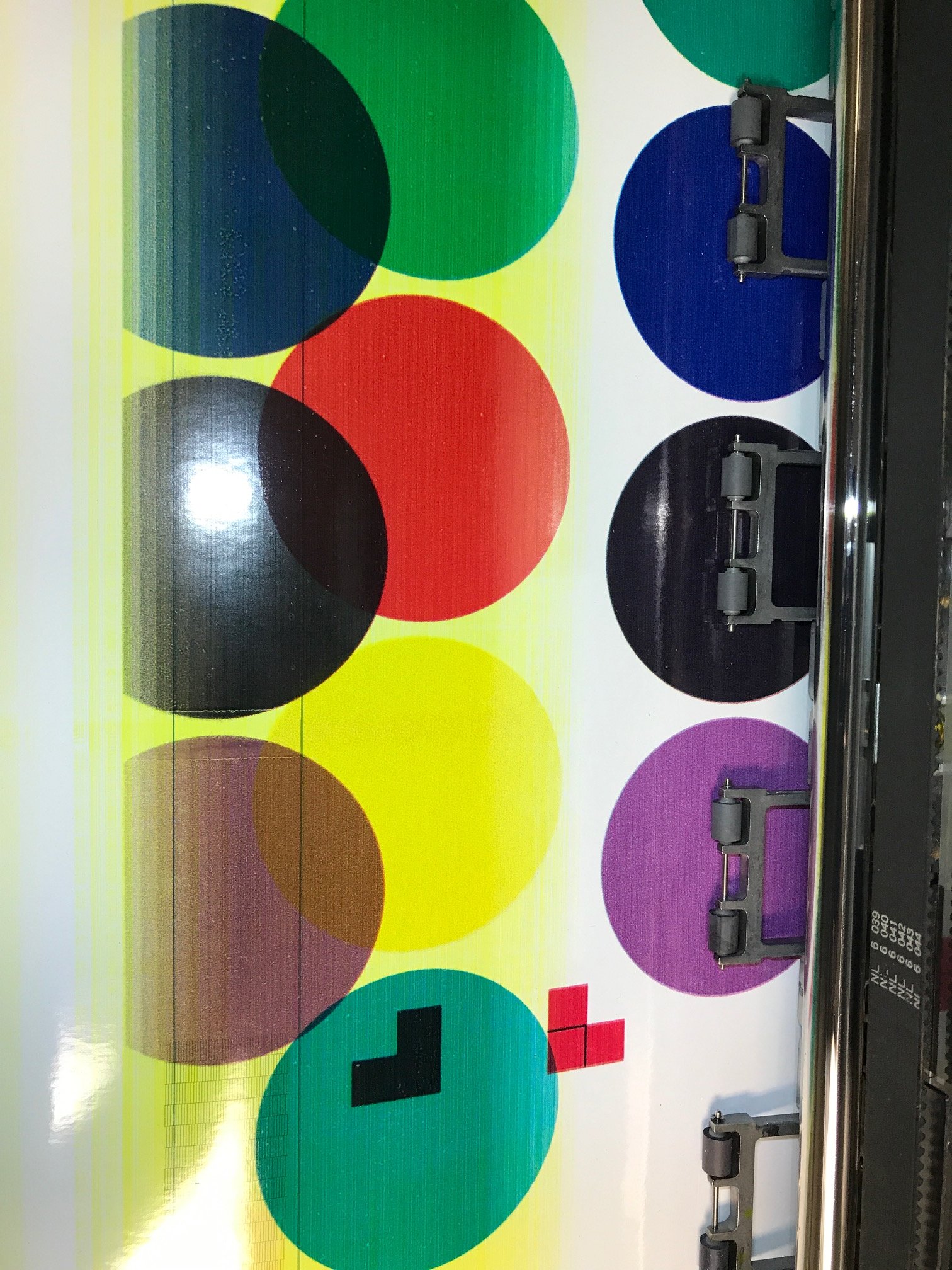

My yellow head is shooting Wide Streaks across the images. I figured it was the Wire connection so I replaced those. It didn't help and then I ordered a new Slider Board and no help. If I remove front Bladder And empty the ink in the head on that side it quits streaking. See image below.

JV3 SP I think? Try with cleaning encoder strip and sensor if have good result change them there arent expensive.
Also if you changed the slider it can be bad yellow cable.
Andy_warp
Also check your printhead connections with the ribbon. Make sure no ink is getting in the way.
Encoder cleaning is a good tip, but I've only ever seen this from a dying printhead or bad communication to a printhead.
