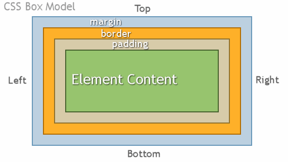

as for cross browser compatability research box models. IE and firefox use a different box model.
the basic are pretty easy, if you want to use padding, padding is the space on the inside of the box before the next element appears.
so if you have a 50x50 div with a padding of 5px, you need to adjust the box size to compensate;
i.e.
#box
width:40px;
height:40px;
padding:5px;
that will give you a total width of 50px;
margins work on the outside spacing
ie.
#box
width:40px;
height:40px;
margin:5px;
both have a total size of 50px, the padding version will pad the inside content by 5px on each side, the margin example will put the content in the content in the 0,0 position of the box, but put a 5px margin on the outside.
so the code above will give you the exact same look for both boxes, just depends on what you are utilizing the boxes for to determin which to use.
attached in an example of a box model that will generally work in all browsers.
artist4christ
Here you go
