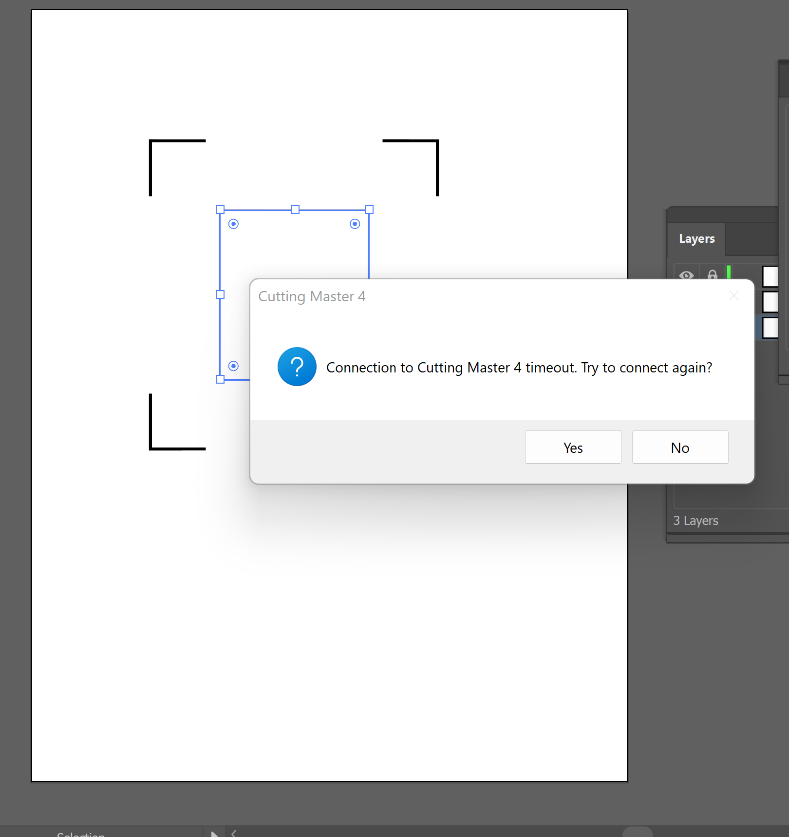

Hello,
I installed AI 2022 with cutmaster 4 and get a time out error when sending to cut/plot using the cutmaster 4 plug in in Adobe Illustrator.
the create registration works though.
I also tried AI 2023 with Cutmaster5 plug in and when I try to create registration marks it doesn't open the registration window. However, in this version the cut/plot works.
I need both registration and cut/plot to work from either version. Does anyone have any in sights on what Illustrator version plays nice with cutmaster 4 or any support would be helpful to get this going. Graphtec support has been very slow to respond so far :-(
T.I.A.

Hello,
T.I.A.
This is what I did when I had the CM4 time out error. It fixed it - I was on windows though,so its a bit different than what the video shows... but you can likely figure it out pretty easy following his mac steps.

artofacks1
I tried that wi no luck :(
