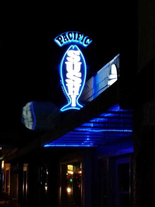

Custom Halo Lit Sign. 3 sq.ft. with lots of WOW
visualeyez

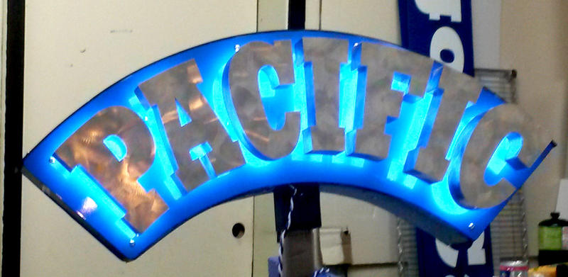

Even under fluorescent lighting, this thing is WOW!

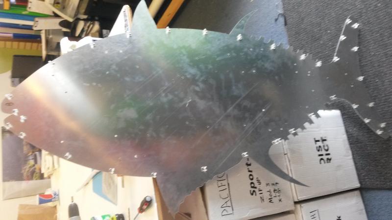

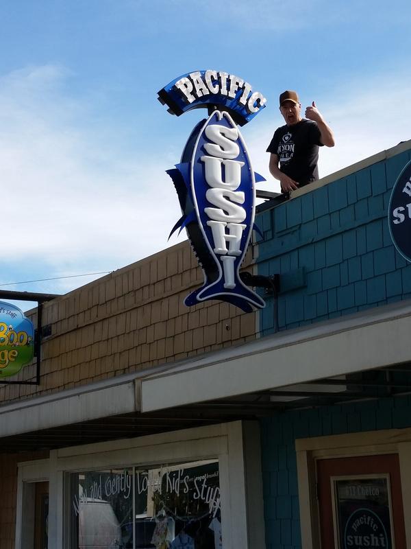

Welded aluminum sub-frame to attach the faces. 1/8" Aluminum faces, cut with jigsaw and painted by AutoBody shop. All holes hand drilled. Custom designed Typeface, Fabricated by Gemini. Stuffed With Aurora G2G Gen III mini modules. Removable stud mounted. All wiring hidden within, and watertight. Power supply with dimmer remotely wired inside building. Sign rides on top of Existing signage, approved for 120mph wind load and the hardest part was
everything!

Turned out pretty good!

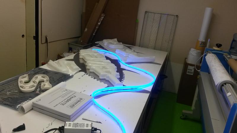

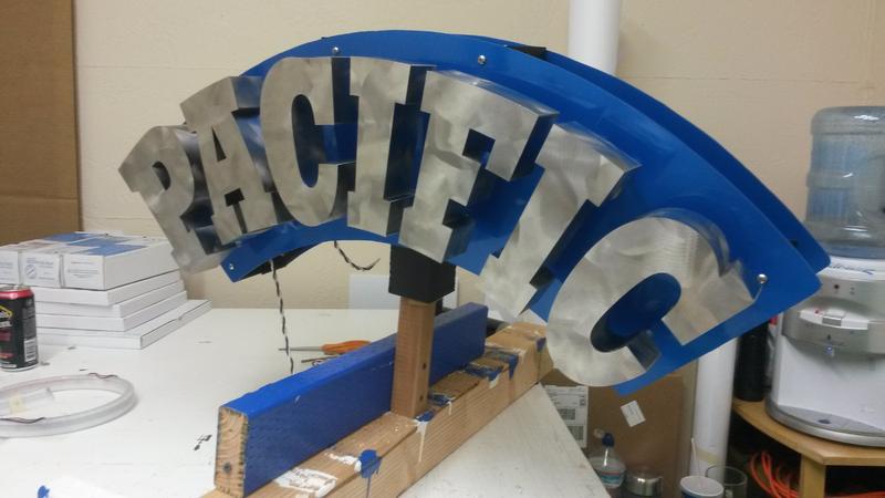

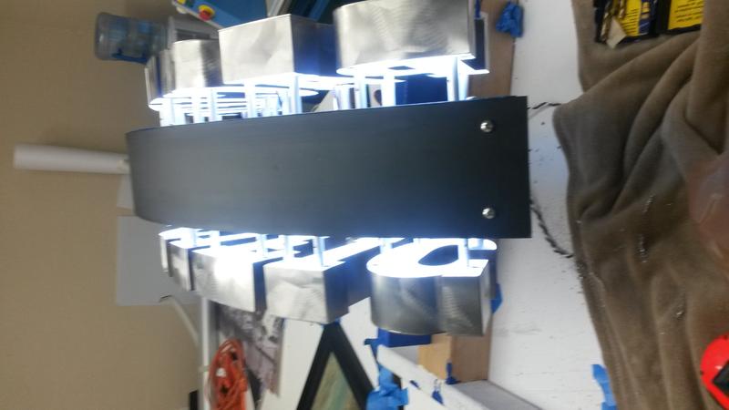

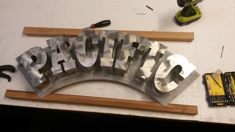

Build Pics
I didn't take too many pictures of this. I didn't get any of the Frames or Brackets somehow. Here is a few I found.

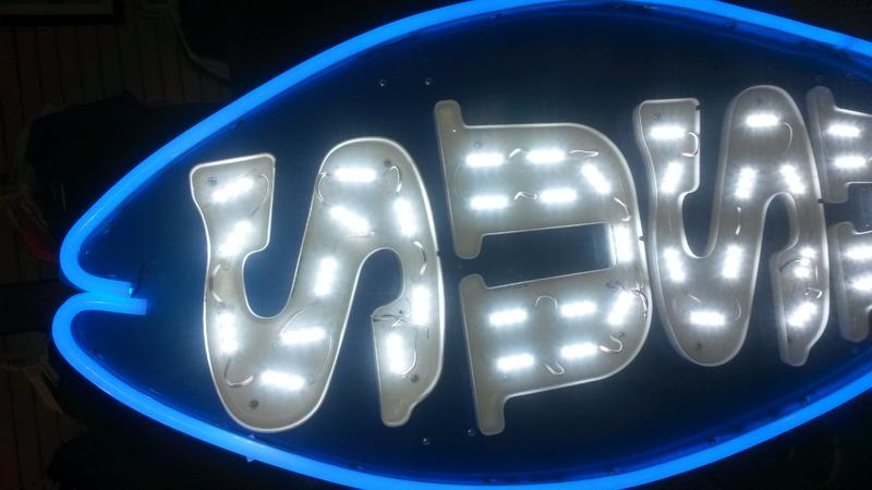

Haha, the Skip-Rope is Sloan FlexiBrite. The blue reatails for around $50 per linear foot. I used just under 30ft. for this sign. The Blue and Green cost 2x what the white, red and orange cost.
visualeyez
Also, at 300 lumens/ft. for the Auraura G2G modules that I overstuffed the SUSHI letters with, we had to dim down to about 20%. Those things are so effing bright, it would have caused car wrecks.
