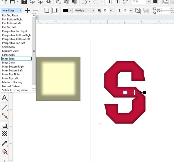

To expound on Asuma01 answer.... Link to YouTube video explaining how do it with contour. But your sample was made with "inner edge" shadow function of CorelDraw 2020 and newer depicted in the attached screeenshot.

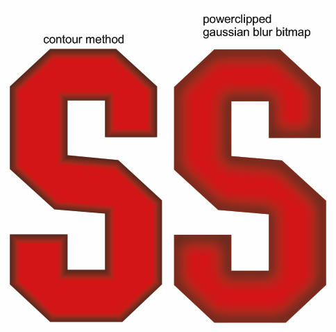

I can add yet another way.
duplicate the text remove the fill and add a thick black outline. Convert it to a transparent bitmap then add a Gaussian Blur adjusted as needed. Use the transparency tool to adjust the opacity. Powerclip that into the original text.
