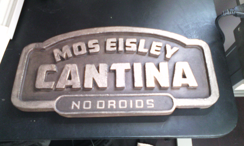

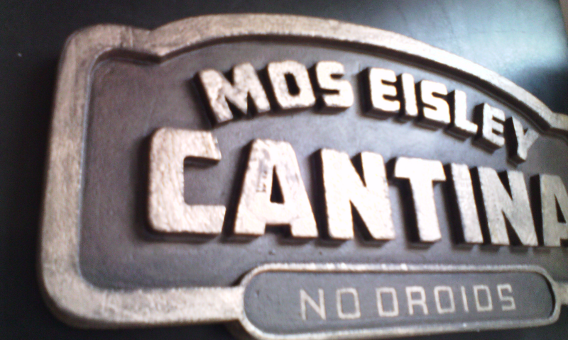

This is my first try at hand routing a sign. I learned a lot with this experiment. The HDU used was a scrap of very low density, I don't think I'd ever use that again for anything other than practice. Sorry for the rough pics.

The background is a Rustoleum texture paint, the name escapes me. The letters and border are Rustoleum Metallic Accents Champagne color, with a wash to "dirty it up"

Haha...no, it wasn't that bad. I'm using a Bosch Colt, which is a pretty light router. It's perfect for signs.

There really aren't any great videos, but some on youtube were helpful. It seems like most people making signs by hand with a router are just making the same cheesy cedar signs with black lettering you buy at all the flea markets.
Honestly, it's not that hard. I just put down vinyl for the pattern, then shot it quick with some spray paint, removed the vinyl, and started routing.
I did modify my router a bit with a larger clear acrylic base to bridge the larger areas. Other than that, just sanding to clean up the edges is the main trick.
Give it a go Scott. It's pretty fulfilling to make something by hand.
I also just ordered some chisels to start practicing hand carving. We'll see how it goes.

I just used an 1/8" straight bit around the lettering and a 3/8" (I think) to route out the background. In the corners of the letters, I had to go back with a box knife to give them more definition, but this is a pretty small sign. On larger signs, I think it would be unnecessary.

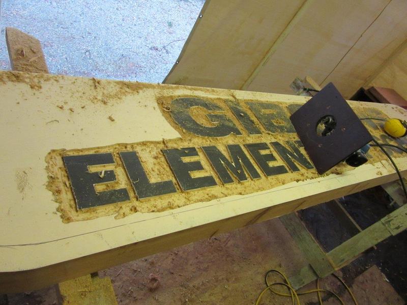

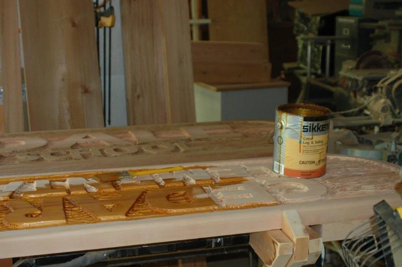

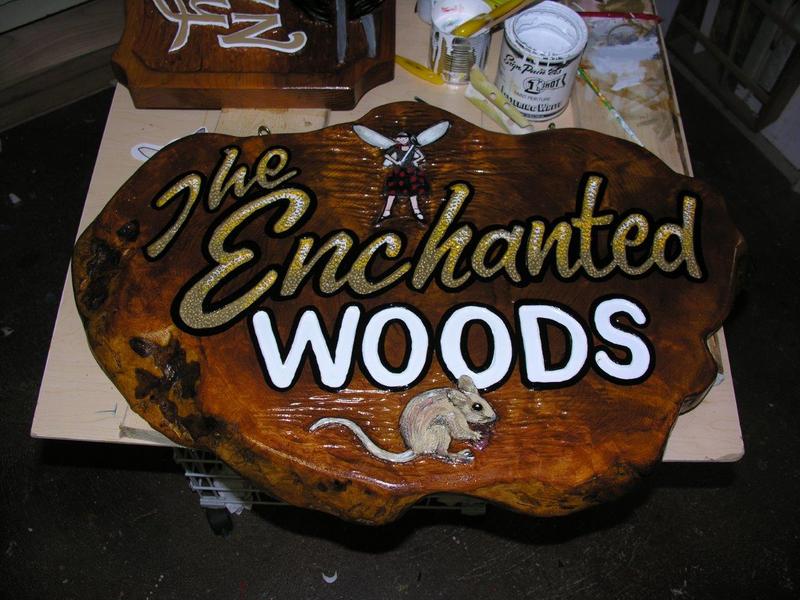

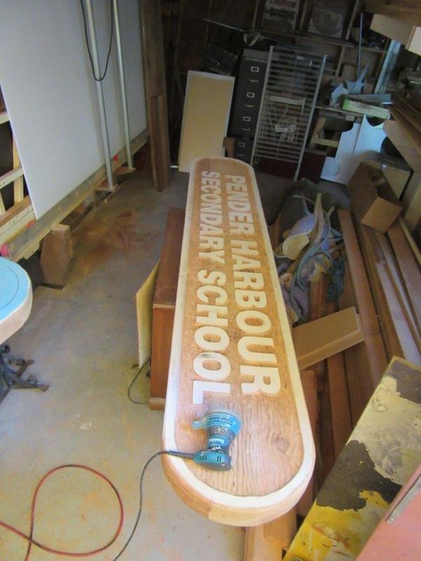

That looks very nice. I do quite a bit of hand routing, mostly cedar. I just finished ten 9 foot by 22" cedar signs for our local school board. I cough cedar clouds now.

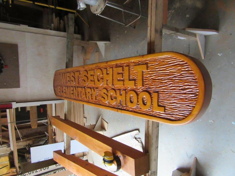

The school signs were first routed around all the letters to a depth of about a half inch. Then the texturing of the background is done with a ball rasp in a die grinder. I used to blast all our cedar signs, but these school signs are gonna get climbed all over by nasty little children and the "venetian blind" texture the blast produces is hard to fix when damage happens. By grinding a faux grain pattern I get a much more durable finish that can be maintained by the school board painters. I just sold off my diesel compressor and I don't plan to blast anymore.

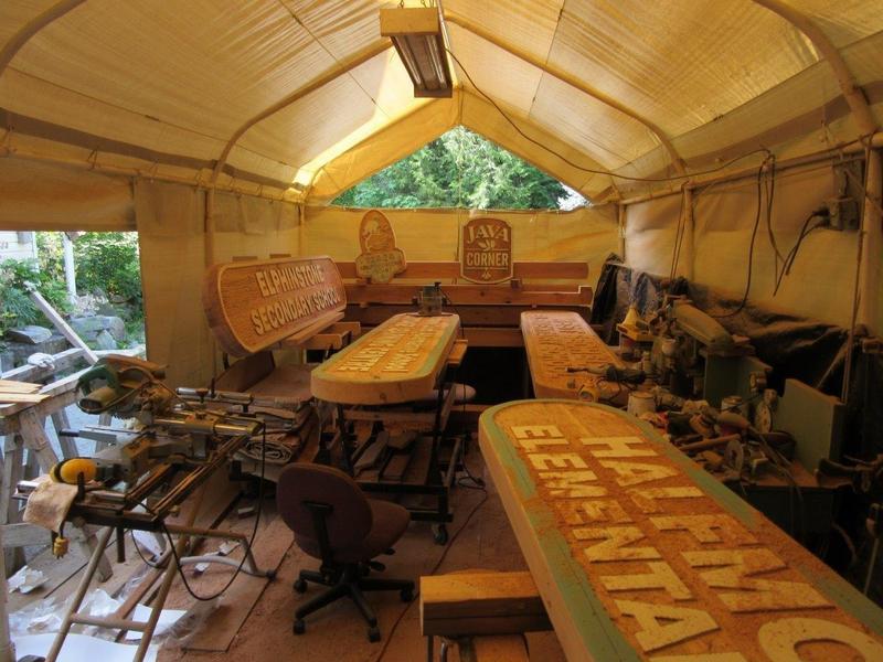

Craig, you would laugh if you saw my shop set-up. It's just the basement of my home and my carport. I put up the tent to do the ten big signs but I do plan to take it back down. It blocks the mountain view.
