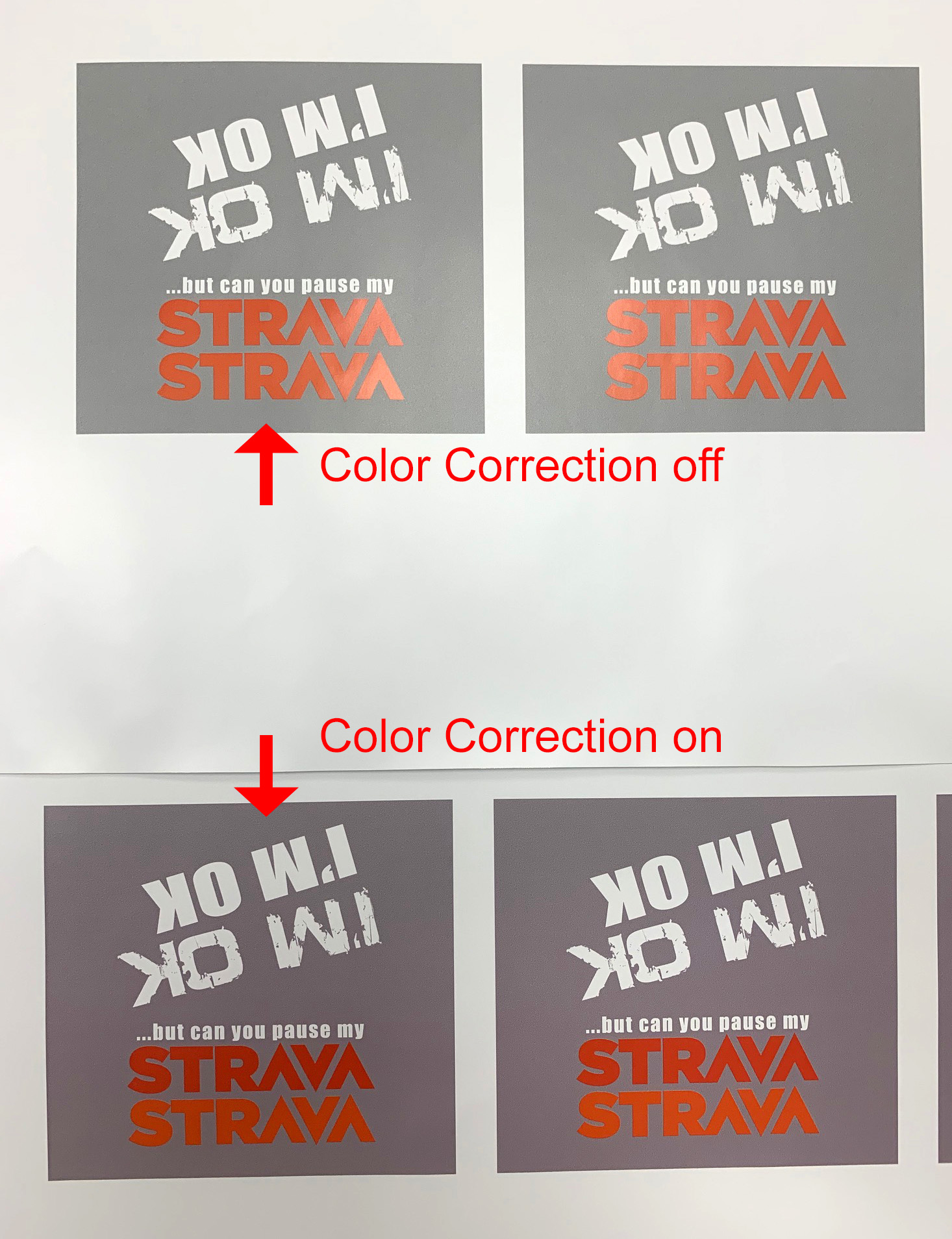

I just ran another file with gray's and this is still a problem for me. With color correction turned off they print like i think they should. Please see attached file.. Anyone have any suggestion as to why this is happening.

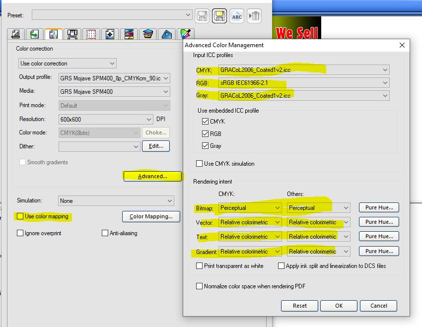

mattc5900 what rip are you using and are any of these colors Pantone Colors? If you are using Flexi and your issue colors are Pantone turn off Use Color Mapping on the Color Management tab of the job. Try and reprint the job using the settings on the attached screen capture, just make sure that the output profile is the one for the media you have loaded.

greysquirrel I was the one that posted the picture that showed Mojave in the output profile. I didn't intend for them to use that output profile, if you look I only highlighted certain areas of the pictures. These settings are what I wanted the original poster to try.

I'm using Flexi.. I have tried running files from flexi19 and 12 and getting about the same results. Media is 3M IJ35C and have it selected output for that media and yes color issues seems to be with Pantone. I have not tried turning color mapping which i will do and see what i get.. Thank you for the input!!!
