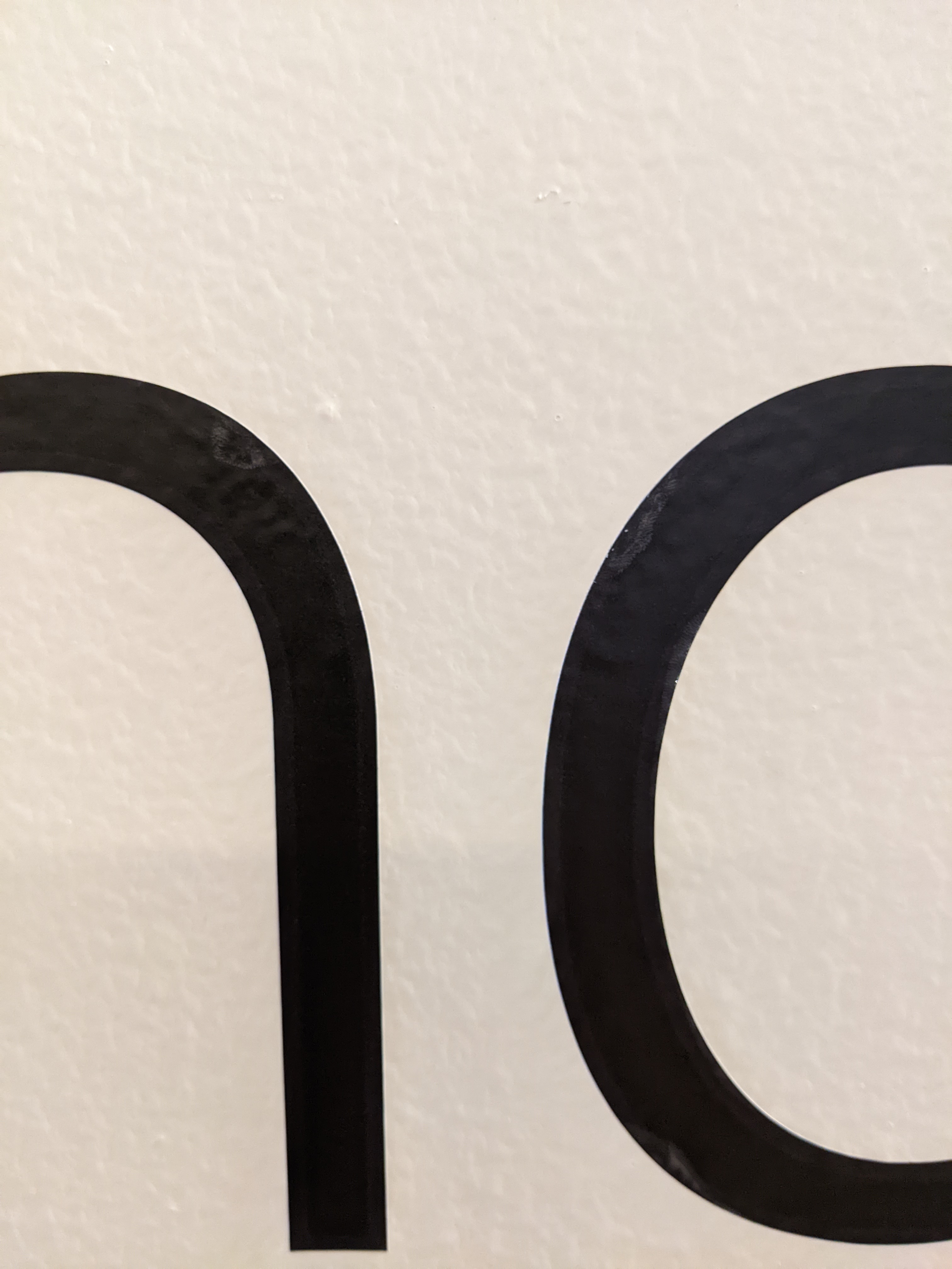

what vinyl and laminate did you use (both cast)? do you have pics of the original problem? based on what you are telling us it sounds like a paint issue

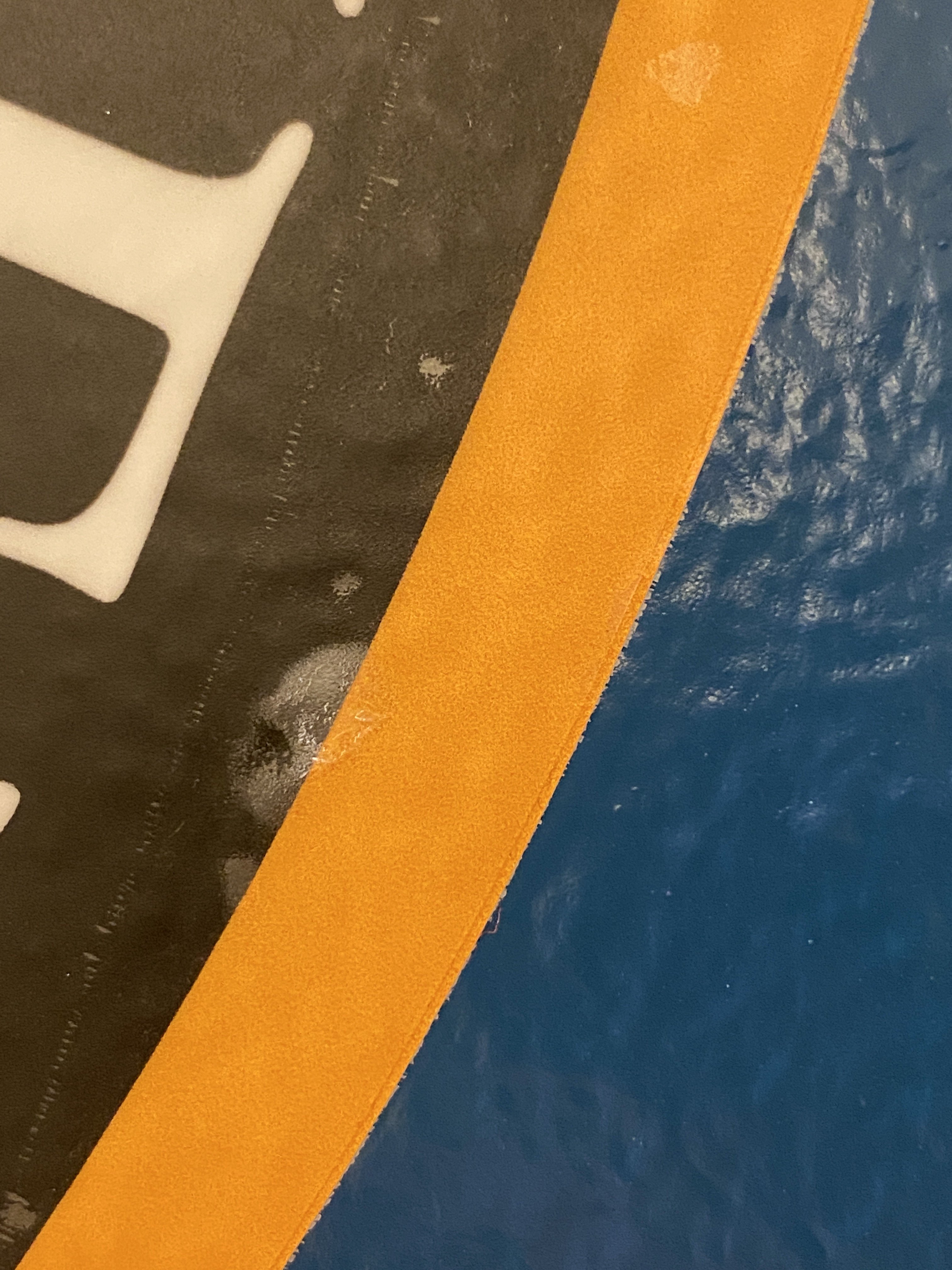

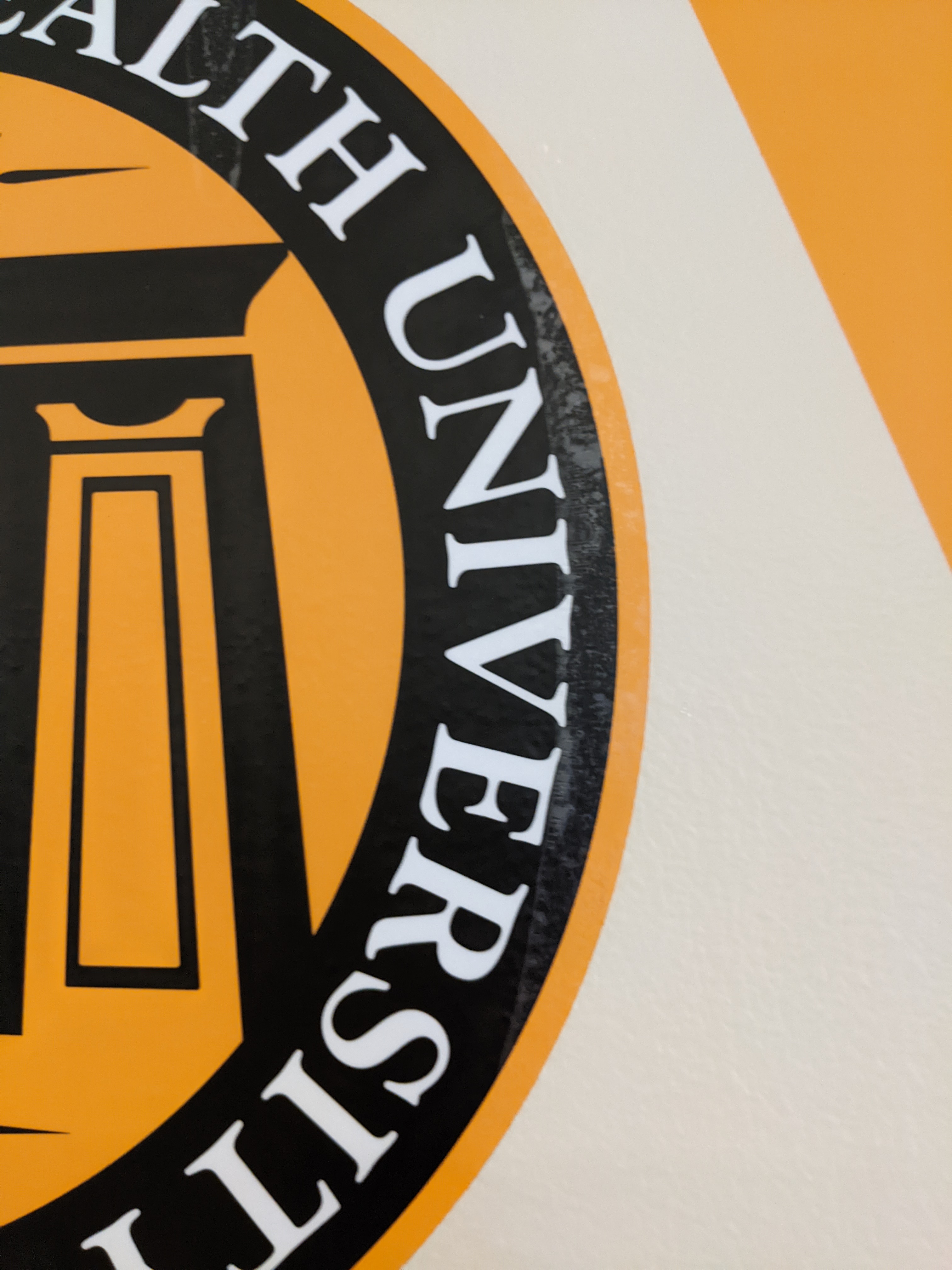

Here's a few photos of the bubbling the visible shrinkage

Are they freshly painted walls? You need to wait a month after painting, I've never seen it cause bubbles but it has flaked off before.
Do you print with latex, or solvent? Did you wait for it to off gas if solvent?

When I was pulling the old decals off the wall paint came off incredibly easily – just picking at the decal with my fingernail caused the paint to peel off.
So Im currently thinking that the paint is probably the main cause of failure but given that this is my first time making a wall decal I probably made some mistakes as well.
I laminated the replacements without any tension so we'll see if that makes any difference...
Given that 70% IPA started to dissolve the paint, are you not supposed to wipe the wall down before applying?
