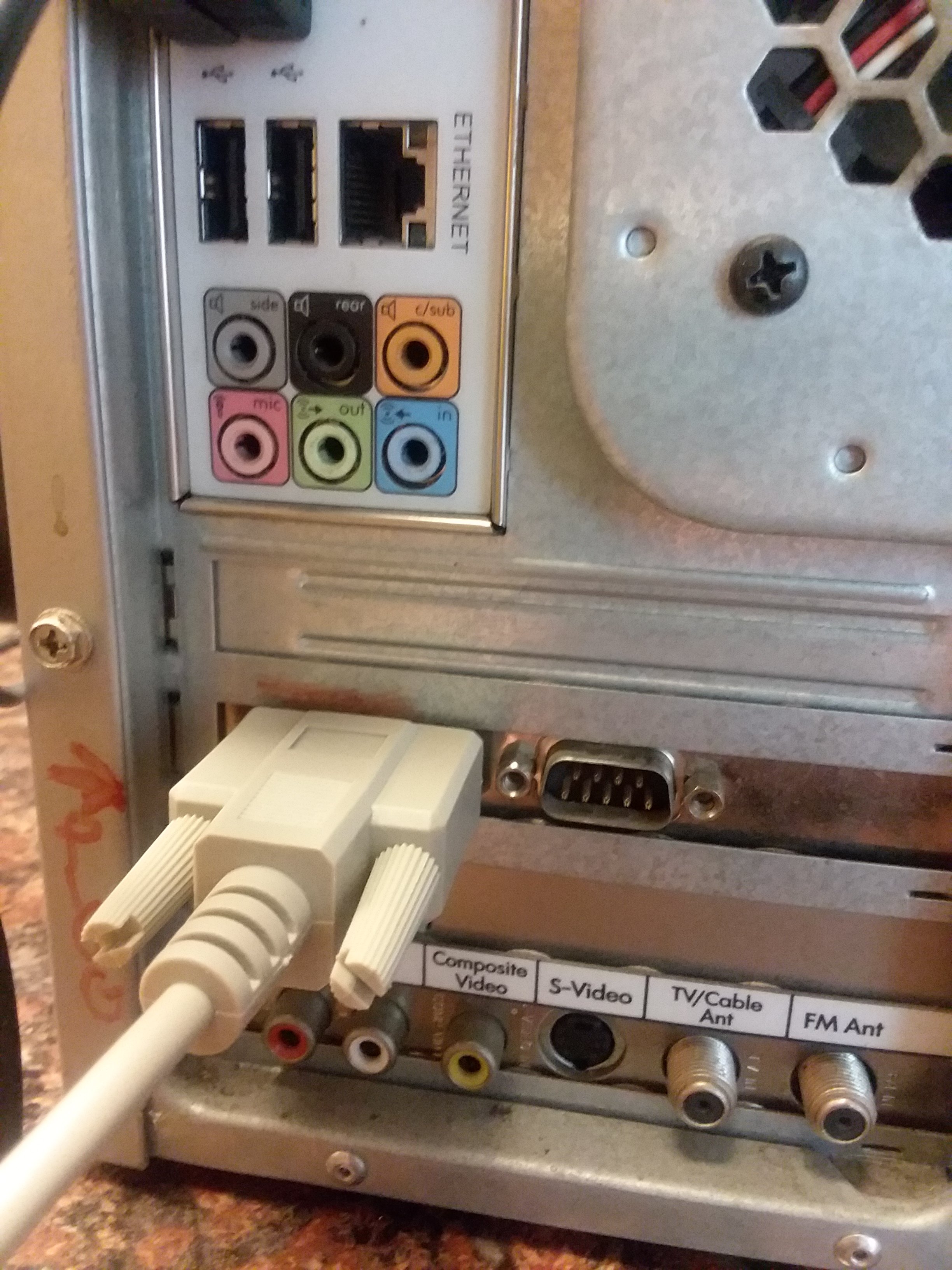

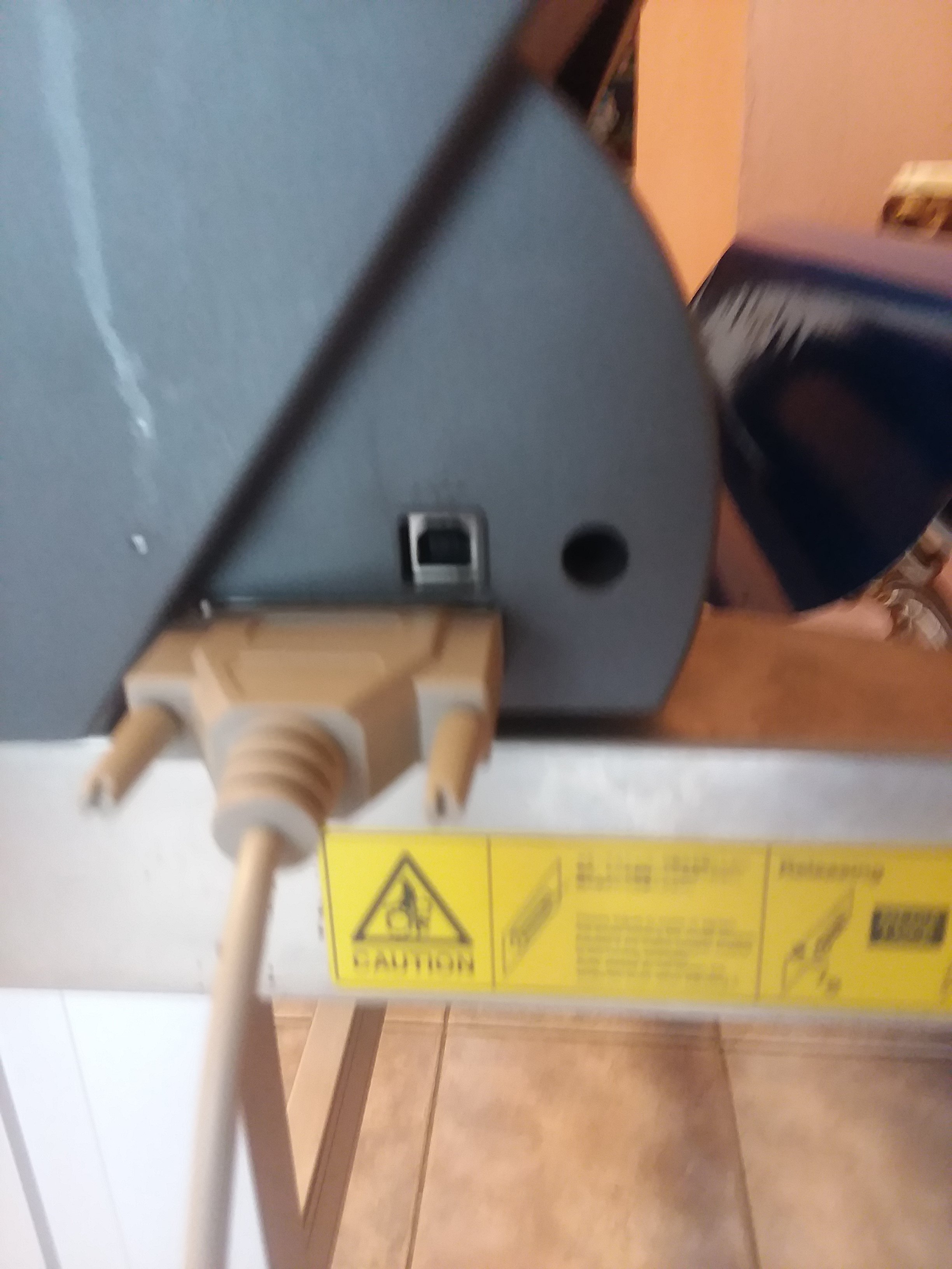

That sounds great but i have a 25 pin serial cable, if i was to use it to connect to a usb slot in back of my pc how will pc recognize the usb if the serial port has 9 pins, so confused, please help
