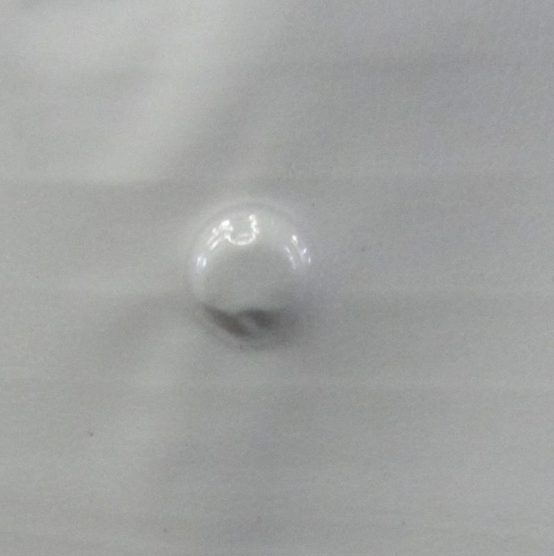

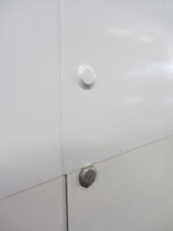

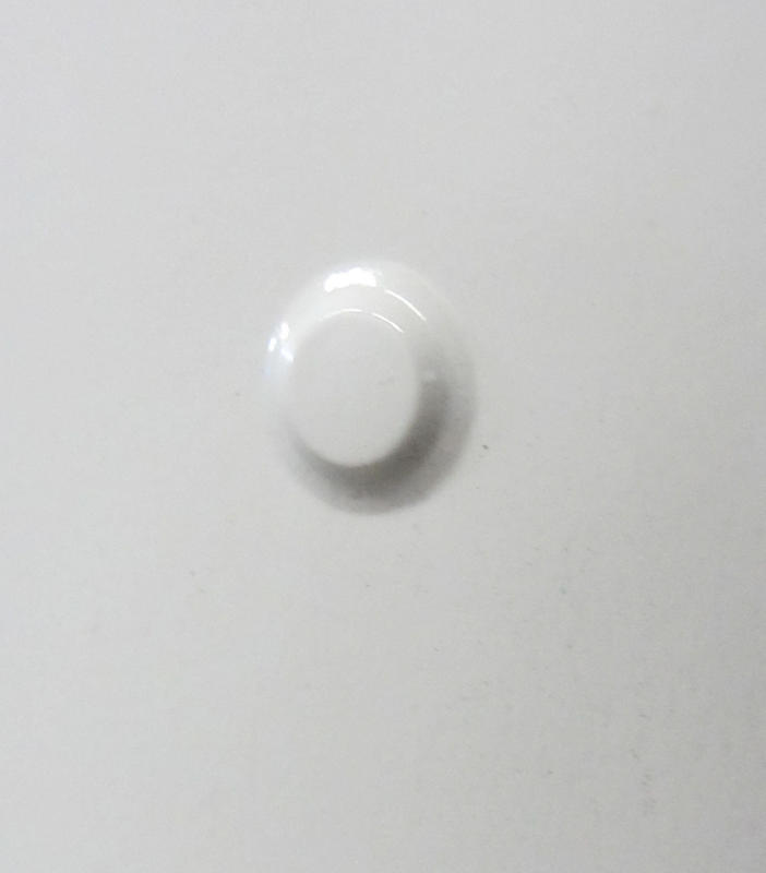

I just tried out the Rollepro on a trailer with rivets. The thing seems to work great but it does not seal the rivet down absolutely all the way. I can't find close up pictures anywhere so I took some. Am I doing this right?
Are the rivets pictured installed as well as the Rollepro can do it? I can go around each rivet with a squeegee and get them sealed right down but I'm wondering if that is what everyone does. No one does it in the Rollepro videos and it it isn't mentioned in any instructions I can find. Should I just leave them as the Rollepro does them?
I have yet to see a trailer here that the rivets have not tented.
The first picture is of the deformed vinyl that I peeled off a rivet. It looks like it has taken a pretty good "set" to me. What do you pros think?

You may need more heat? I had the same problem and then did some testing on different rivets. On some it took a lot of heat to get it right. I almost thought I was going to melt the vinyl at one point. So I'd say take some scrap vinyl and do some tests around the rivets first to get an idea of how much heat it will take to seal it properly.John

These were practice runs John. I think I got it pretty hot but the trailer was cold. I can't get the trailer or the shop much warmer than 60 degrees. It's the customers shop and they just don't heat these places very well. I suspect it would work a little better in the summer. Not an option unfortunately.
Do you have or know of any close up pictures of the rivets done by a Rollepro? I can't fathom how a company could sell a product for doing rivets and not show a close in shot of the magic tool doing it's magic. Baffling.
