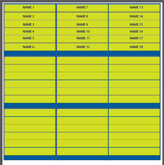

I've got an interesting problem where I need to attack variable data sets differently to how I have done in the past.
In the past, I've loaded CSV files directly in to VersaWorks and set them up from there. Now I require slightly more control, however the information I can find on variable data does not suggest to me that what I want to do can be done.
I need to set up these files to a particular dimension in a specific way multiple times over (2500 to be exact) but the way in which variable data is managed in Illustrator seems to make this task impossible or at least very clumsy to handle.
See attached image for what I mean.
Each CSV file has 100 or so names (100 exactly I think) and there are 100 boxes. I need to be able to exchange a data set out for a new one and populate the boxes as shown in lots of 100.
As far as I can tell, InDesign is the only application with a way to do this, but do you think I can figure it out? I've tried internet tutorials, but they all seem to want to do business cards in mass and not anything similar to this, so I'm lost.
Can anyone point me in the right direction?
I have Illustrator/InDesign and FlexiSign at my disposal if that helps.

To give you a better idea of what we are trying to do, is put names on crosses for a display. We have 2500 of them to do with only a small guillotine to cut them up, hence the specific arrangement to cut down cutting time.
The order does not matter at all. In my screenshot below shows a row of blocks with names. The other blocks will also have names, so this is just an example. We have around 20 CSV files (but can request them in whatever file type we like) which we would usually push directly in to VersaWorks and set up from there, but what we want to do now is slightly more complex.
Once set up, a PDF or EPS will be saved and they will be sent to VersaWorks and printed that way.
Ideally, what we want out of all this, is the ability to take a CSV (or whatever is required) and tell the software "Here is my data, please put it in my pre-defined boxes the way I told you to". Each set would be arranged the same way in the same format and within the same template with the obvious change being the names only.
I had a play with InDesign and worked out how to import sets of data, but have not yet worked out how to assign them to a template with my desired fields. The closest I've gotten is arranging them all on a page with specific margins and dimensions.
I feel like I'm on the right track, but this is all very new to me. I'll definitely be watching some YouTube tutorials on this. I'll be looking in to Marcom Fusion Pro also. This is going to be an on-going thing, so if there is any automated solution out there to decrease the intensity of the labour involved, I'm interested!
