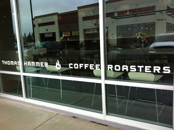

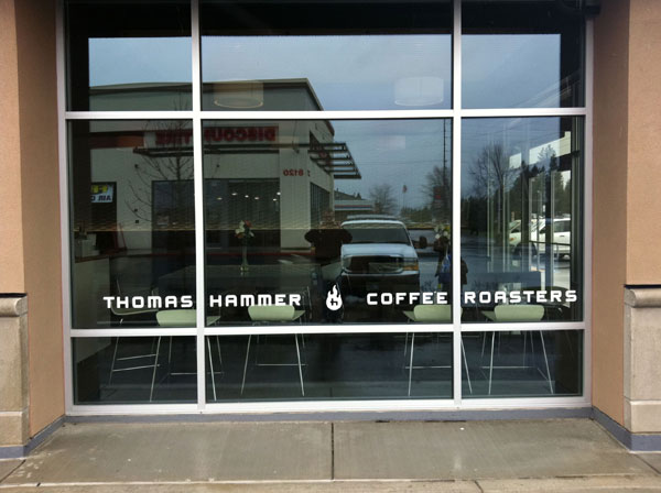

Thanks guys! I was freezing my butt off since I totally dressed for the nice weather we had this last weekend, but it worked out! I've attached the finished product.
