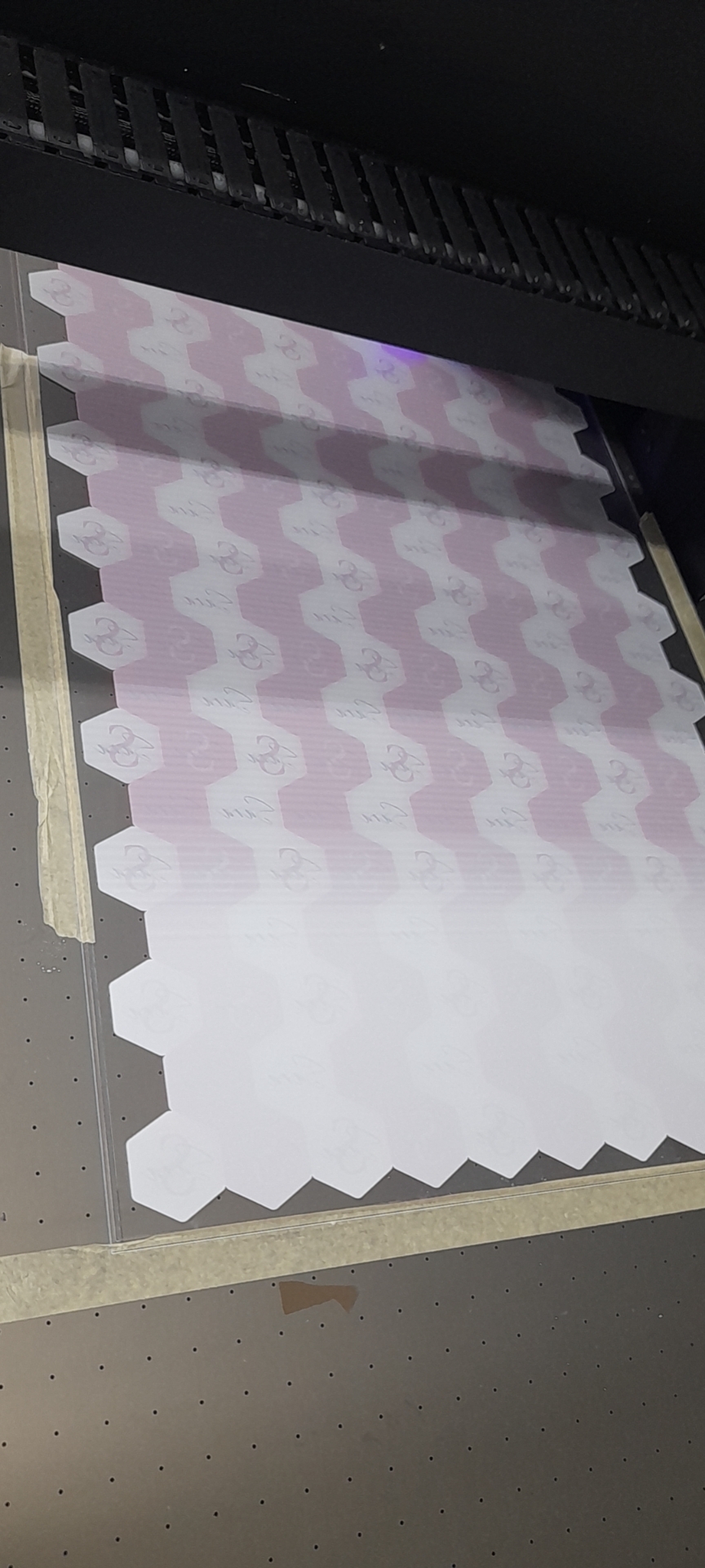

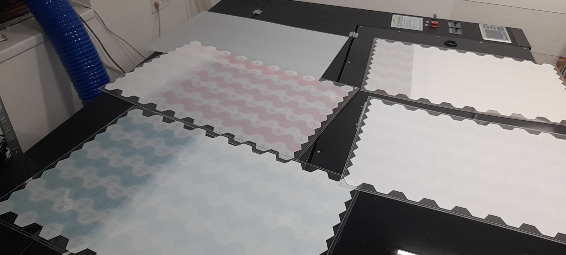

Hi friends,
Please could anyone give me oppinion why white is nit stabile,start perfect but cant finish like that,finish weak.
Maybe some bady has similar problem.
I use Sakata inks,CE4M toshiba heads.
Thanks a lot.
Jey.

ToTo
Professional Support
Seems that you are loosing nozzles on high ink load. This could be related to almost everything. Meniscus to low or instable, ink flow, filter in PH, …
Broome Signs
White ink settles in the box very fast, we always give the white a good shake and print about .5m before running the job
osam
Thanks friend for answer,.
I changed from subtank all,new pipe,new filter,new cable connector.
Test nizzles before printing,was ok.
First time was all ok,750x550 acryl,second time loose nozzles.thanks
