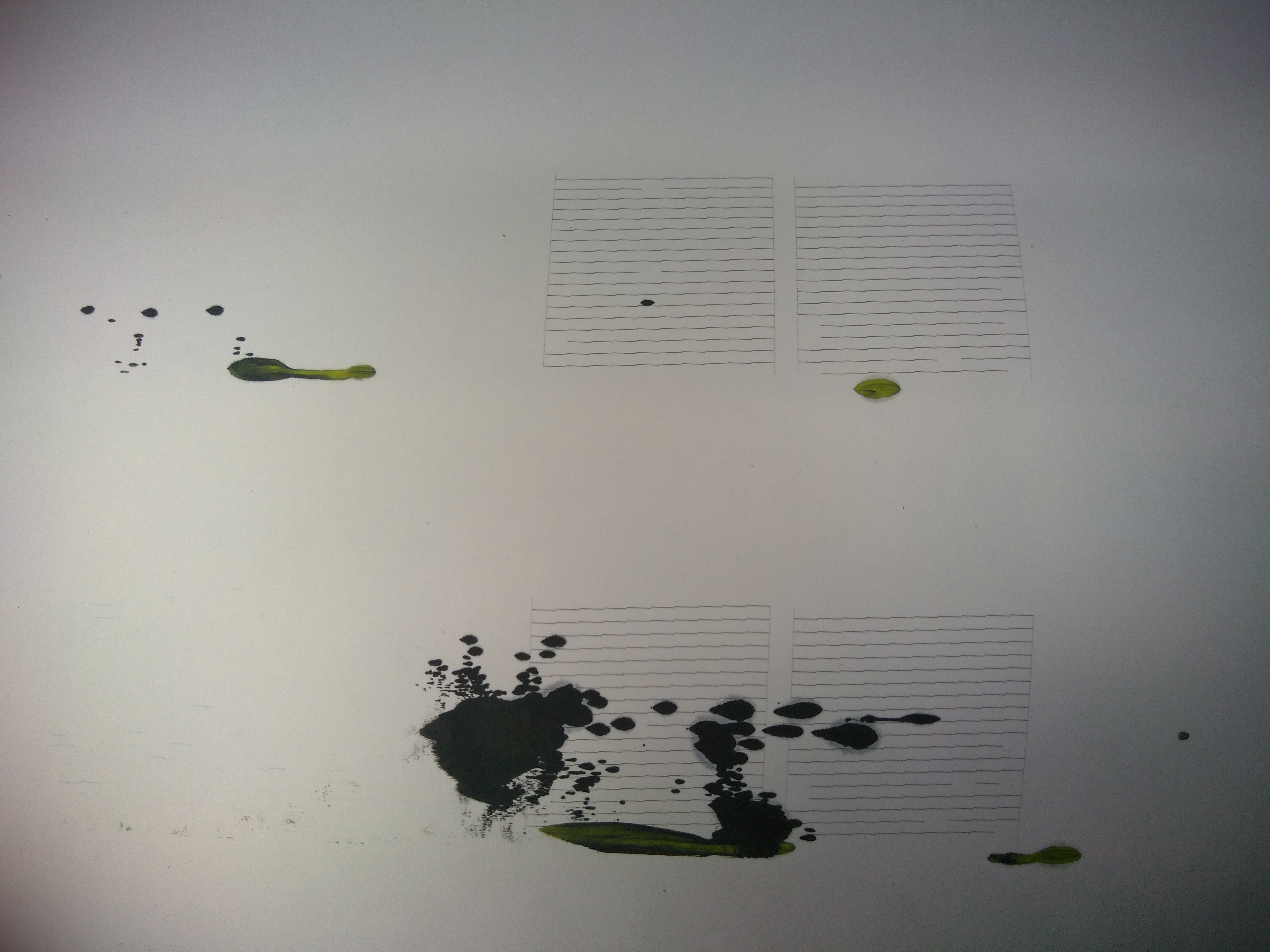

I have a Alpha GD18-E aka "china printer" with software of PhotoPRINT DX11... I can't even get the software to up load. can someone help?
This photo is what I get when I hit test print...

Wow that looks like a mess. I'm not sure you may find help with that here. Have you tried contacting the manufacture or person you bought it from?

I mean, regardless of printer make, they all work the same way. I can't find that model number on google? I'm assuming it's a basic R2R small solvent unit.
There's obviously still ink all over the head after it wipes. Check the wiper, it could also be the capping station or clogs on the pump side so it's not getting proper vacuum. In that case, you'll have to heavily clean out the capping station and lines from the caps to the pumps to the waste tank. The "splurging ink" issue is usually never indicative of a head/damper/line issue before the heads.
Not being snarky, but do you know much about printers? This is a pretty normal issue, but if this isn't your normal wheelhouse then you definitely need to buy a unit that comes with a warranty or purchase a support plan. Once you get experience dealing with these types of problems then you can easily survive the world of discount machines, used units, and contract-free operations.

Probably it's an Alpha GD1800-E2...but it doesn't matter that much...the working principle is the same.
You can also search on Google for this forum: sign-forum.ru (you'll have to use Google Translate). They know chinese printers very well and could also help you with the software problem.You can write them in english.
But it would be more easier...and a lot faster... if you could get a qualified technician to look at it.
