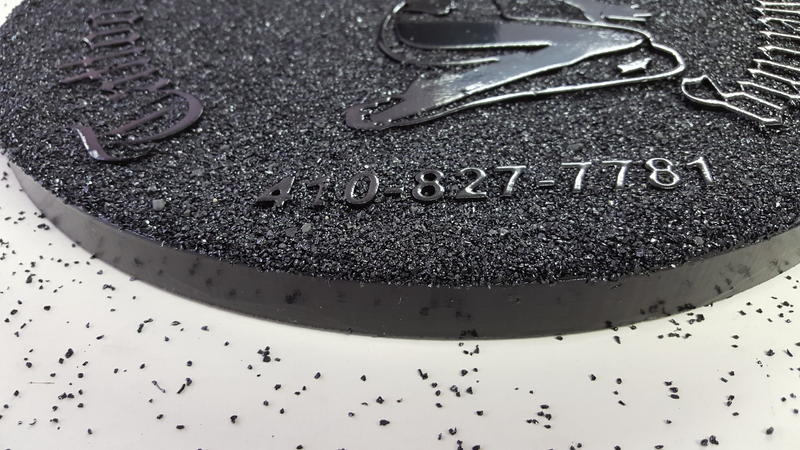

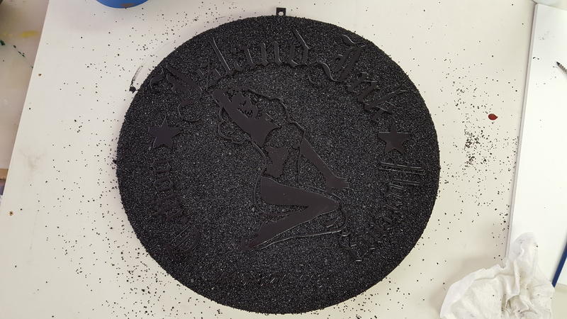

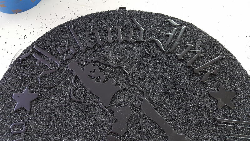

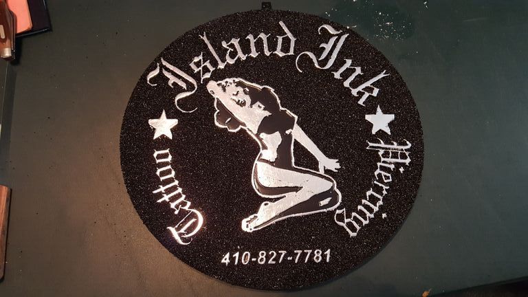

I am working on a Smalts sample/Christmas present for my brother in law that owns a tattoo parlor.
This is 15 lb sign foam, with the background routed out. I painted it black, and applied black one shot and smiths cream 50/50 mix. The smalts was given to me by Michael Clanton. He had won it in one of the resident drawings on Letterville, but he doesn't use it, so he generously sent it to me, and asked that when I used it, post up photos.
