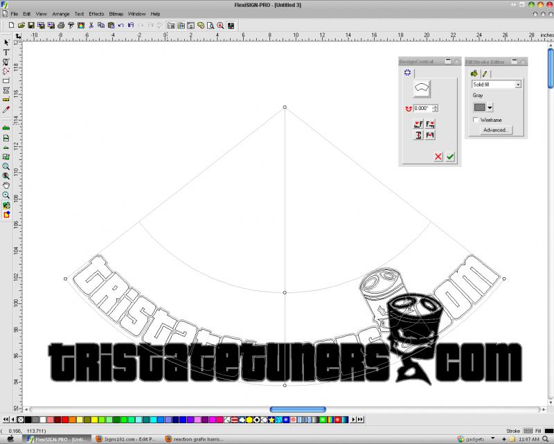

A customer provided me with an EPS of their logo. He wants me to cut it into windshield banners. How would I go about arching the logo to fit the curve of the windshield??

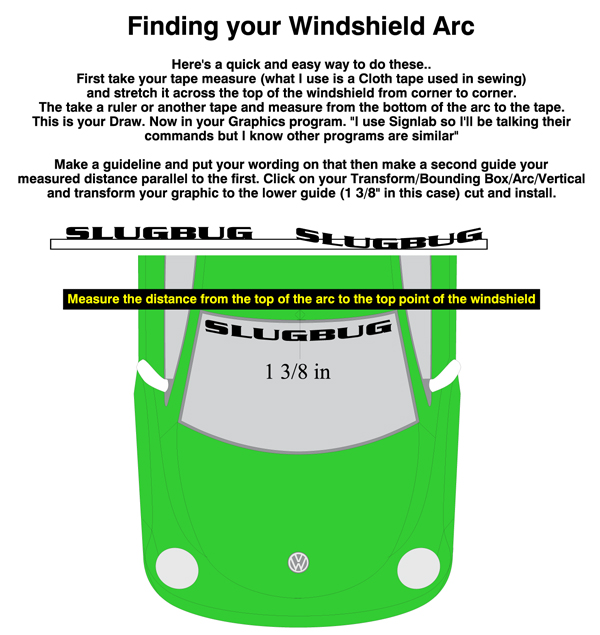

from http://www.signs101.com/content/tips_tricks/

I use Flexi 7.5. Under effects / distortion click on polygon shape to get you to distortion menu. There are about 15 different effects, each effect has a submenu with additional options. Once you get to the effect you want just click on the boundary box points to adjust the effect you want.

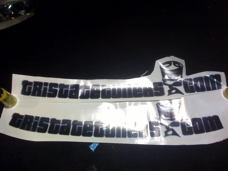

i hope this helps
the first is the logo
the second is what he wants at 36" in length by proportional height
the third is a screen shot of what i was doing with the distort option
