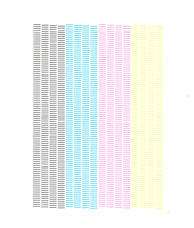

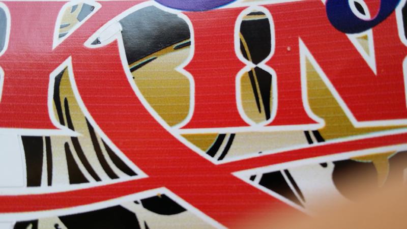

Why do my prints have lines or banding on them,am i using the correct profile or setting, also it is a vector file that i export as eps and i have a versacamm dp300v

Brendan
pretty nozzle check.... make sure there is slack in the media and that the machine isnt pulling against the weight of the roll. These machines dont do well pulling any kind of weight.
In Print
from the nozzle test it looks like some magenta and black nozzles are misdirected, that could cause those lines. Its not alot but I have had a single blocked nozzle do that.
Bretbyron
The lines do not look like they are going through the Cyan and Black. If it was a feed issue wouldn't it go through all colors?
MikePro
definitely a feed compensation issue. white lines means your printer is feeding too much material per pass of the printheads.
+1 to a misalignment issue, in addition to feed comp. Most likely in your bidirectional alignment.

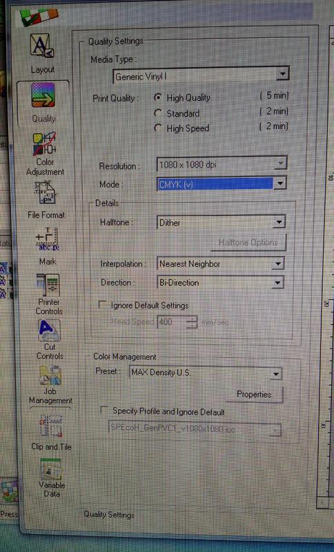

Drip Dry
Is "Generic vinyl" the profile your using ?
I assume your printing on a standard glossy vinyl.
If so, try using the "GCVP" profile. I've always had good success with that.

Assuming your feed calibration is correct....and your print heads are aligned properly.
As suggested above, try GCVP or go download Oracal's 3165G Profile and try that. 3165G profile seems to print almost everything on that machine.
