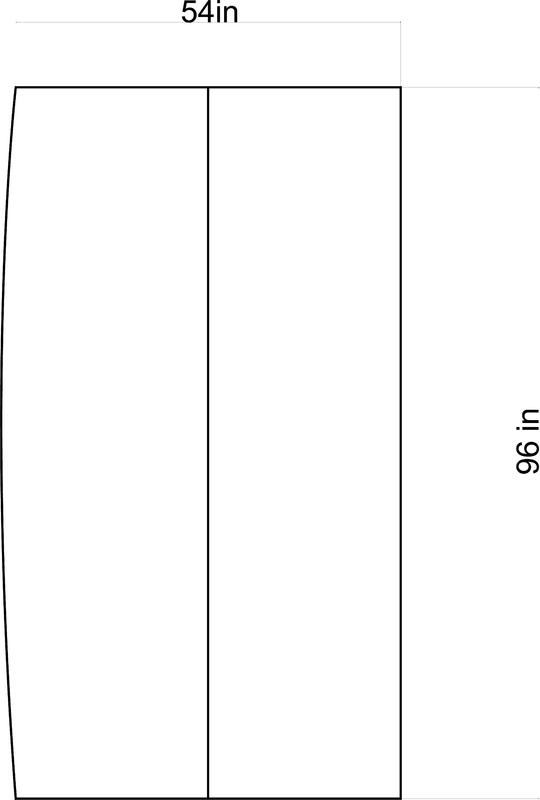

Is it possible to get pictures. So Your print looks like this?
If so that is a really strange bow. And if the print still looks fine I think you have some major tracking issues. And or you have some big piece of sheeting on the left side of the rollers causing it to run sideways.
