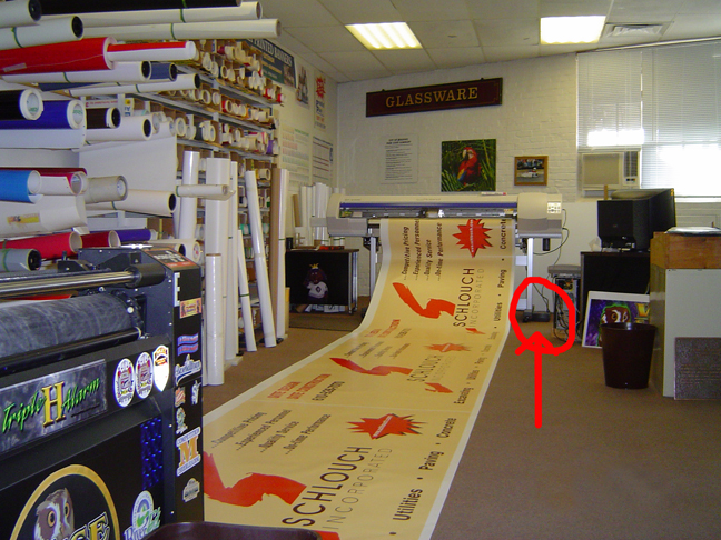

We’re using an APC 725 on our 540. Had to use it several times. Works like a champ.
With the 725, we figured it had enough ‘Umpf’ to get 6’ of printing finished and cut most average projects in normal mode. If a job just started and it’s 12’ long, we’ll stop it if it didn’t get ½ way yet. If it passed the ½ way mark, we’ll let it do the remainder and that’s how we figured on a 6’ time frame.
