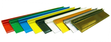

The way we did it up until that point was by using profiles like these:
We never liked the look of these profiles either and since the client didn't like them either we set out to make a better channel letter.

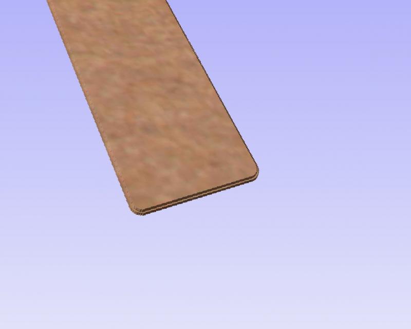

So instead of the acrylic going into a channel in the side (like on the channel letter coil) we routed a channel into the acrylic face that is wide as the aluminium side is thick and then bent and glued the aluminium side along that channel. That way there is no trimcap, the aluminium goes into the acrylic face instead of the acrylic face going into a channel inside the coil.
Hopefully that makes sense. I've also attached a photo that will hopefully explain better.

how do you open it to service then?
best bet for acrylic => aluminum adhesive would be LORDS i think, but it would dim the edges...
IMO your expectations are too high
trim cap isnt ugly, its necessary
