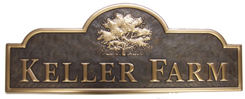

I ran across this guys website in Colorado and he does some really nice work. He produces an "Oil Rubbed Finish" on some of his signs and it looks really cool. I know he is carving with a CNC then, applying this finish afterward. Does any one know what the process is or the product used to apply to the sign?

Looks like LuminOre to me. It's like metal paint. Pretty cool.
Sophistocated Finishes has something similar, but much less expensive. The effect isn't as good as LuminOre, but if you're good at faux finishing and combine a few colors you can get an extremely nice finish with it.

Looks like LuminOre to me, too. He does say it's a metal finish that he rubs and polishes to obtain the final look.
