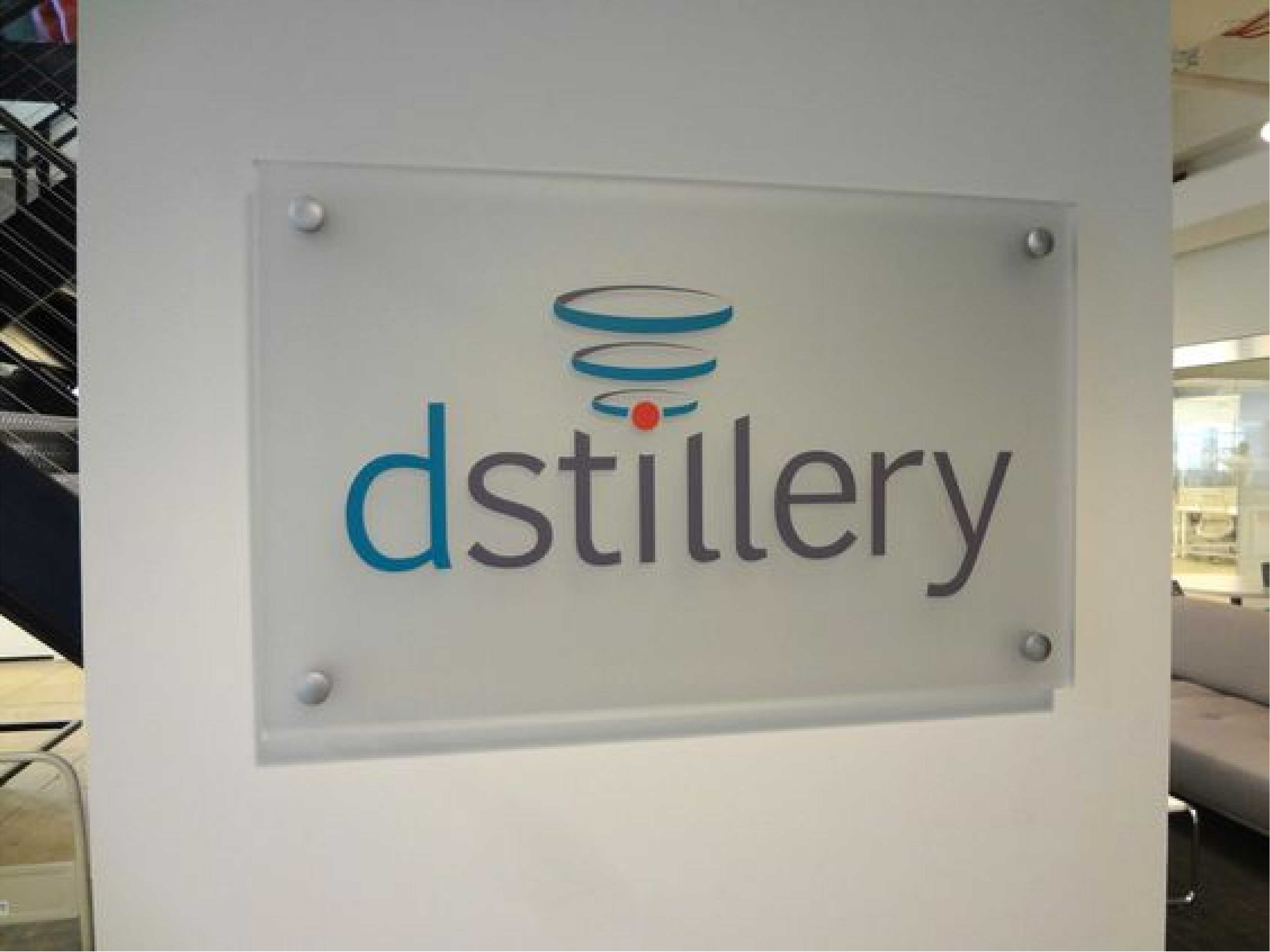

I have a customer that is wanting a frosted acrylic sign like the one in the picture with their logo. Why can I have one made? Thanks for your help in advance!

There's a plethora of ways to accomplish that. What's your skill level ?? Your profile says you have none.
DerbyCitySignGuy
Direct print. If you don't have that capability, color match and print on vinyl or use color matched cut vinyl (or as close as you can get).
If you just want to have one made, DM me for a quote.
Johnny Best
You can buy that frosted acrylic from a plastic distributor, they will even cut the size you need, the stand offs from Grimco or Outwater, or DisplaysToGo and cut the logo vinyl on a plotter. Very easy sign to fabricate.
Good luck!
Oracal 651 Matte Transparent printed with eco-solvent, works beautifully. I can print it for you - shipping takes two weeks.
