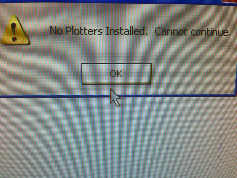

I had to do a system restore, and for some reason graphix advantage doesnt have my plotter installed, anyone know how to get to that screen where you can pick the plotters make and model?

Oh u mean when i go to start, all programs, but nothing is there, im using the oldest pc we have, its an xp

Next place to look then would be the Gerber GA Group at Start > Programs. It's been a long time since I had GA on my computers.

I went on my newer pcs with omega 5, and i see what you guys are talking bout, but i cant firgure this out on this old xp

It sounds like the restore did not fix up all the Start menu items. Try this, find the Gerber software folder (maybe C:\GSP\.... in that folder there should be a gspsetup.exe. This is from memory as the GA is way out of date. The gspsetup.exe ends up modifying the c:\Windows\gsp.ini file. No telling what happened on the restore.
