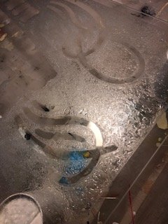

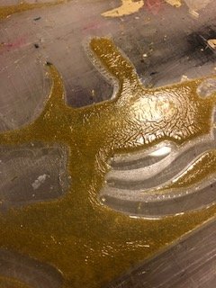

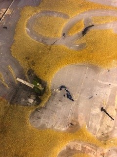

This is my second test peice - Got the glass sandblasted exact same way as i did previously which chipped fairly well but this time the glue just seemed to not do anything. it dried into tiny tiny little chips which give a texture but im missing the really big chips. It did a few at the edge and then it merged into the smaller chips. I washed the glue off after a few days and reapplied the glue chipping again - same issue. I washed glass again and did a final coat with brand new glue and again same result.
Am i laying the glue down to thick (was going for an 1/8th thk and its just not drying properly - is the glue im using just not the right stuff? (its rabbit hide glue)
Once I add the glue i let it dry for a couple days on top of some florescent tubes in a low profile carboard box. I left this final iteration drying for a week and still no real chip. (my house it a constant 68-72 deg range with low humidity.)
anyone out there who can read the glue like tea leaves and let me know where im going wrong. im about to start a final test so would like this one to actually be a success lol.

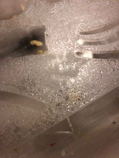

funny you should say that because I did the idiot move of not cleaning the glass right after sandblasting.
It came out just like shown in the photo. When i went to redo the piece and washed all the glue off I could feel the grit of the sandblaster so that was a definite not good start.
So I chalked that upto a lesson learned and thoroughly washed the glass in the sink until i couldn't feel anymore grit coming off it.
Then re masked the same piece carefully in the same place and poured a new layer of glue as a fresh start.
My line of thinking being since there was now some slight chipping that had occurred its
just more texture for the glue to grip. But it still dried the same as shown in the photo - tiny little pockets of chipping.

appreciate the thought - yes lots of variables which always make it tricky but been trying to keep it consistent - same glue used, same water ratio, same sandblast grit, same type of glass. I have an electronic temp gauge so get the glue to 120 deg. which is what i was told was the correct temp. Ill then let it dry over fluorescent lights for a few days to let it thoroughly dry out. Really bit of a head scratcher.
edit: so i just did some quick googling and im seeing some people say it should be heated to 140 - 150 deg. - maybe thats the issue?
