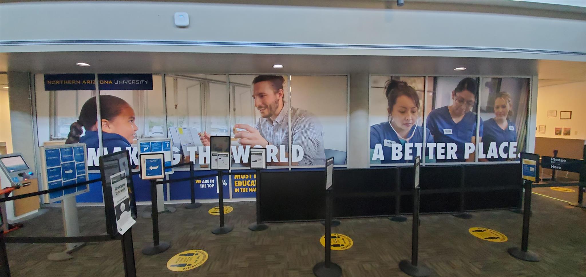

Hey all,
We have a recurring job at our local airport. The graphics are full window coverings on several window panes - large top panes from ceiling to about waist height, and smaller bottom panels from waist high to the floor. The windows are along TSA security, so we're using a gray-backed adhesive.
We just installed the 2nd round of graphics. The first time, we used 3M LX480mC high-performance, removable cast film. The removal was kind of tough, but manageable. This time around, we decided to go to an intermediate film. We have 3M IJ35C calendered on-hand, and we use it for quite a lot of different things. So, we printed the 2nd round of graphics on that. They've been installed for a few weeks now. My supervisor and I had a meeting and this job came up. We started discussing the different adhesive types - removable vs interchangeable vs permanent - and realized that the IJ35C is a permanent adhesive.
These graphics are probably going to be up for the next 6 months, or so (we're thinking it's going to be a bi-annual project). Is it going to be an absolute nightmare to remove the IJ35C from these glass windows?! Should we reprint and re-install sooner, rather than later, on a "removable" adhesive film? We have 3M 48C that we can reprint on, it's intermediate/removable. Wondering if anyone else has been in this situation before? Any media recommendations? Gray-back, air-release, ideally a 60" roll (but we can tile panels on 54" if needed), latex-compatible, ideal for short-term window graphics?
Thanks, y'all. I always appreciate the insight!

Dan360
We use 40c for stuff like this for the same concerns you have with 35 on windows. You may be able to use IJ-36 as well if it's such short term, we've used it for a week long event and it was great. Customer removed themselves after since it was so easy.
weyandsign
I've removed quite a few permanent adhesive printed vinyl decals (Orajet 3551RA) that have been on windows for over a year outside, and never had a problem peeling it off. Some peel off much harder than others, but they do come off. But do what you think is best. Nice job by the way. I'm sad you didn't split the window frame thru someone's face on the graphic, lol.
PrintQueen
thank you! i'm hoping it won't be too much of an issue, since we would have to eat the cost of the reprint. thankfully, i don't design the graphics, or you bet I would make them split in the most inconvenient places :p haha.. really though, i saw some graphics installed like that in our mall, and it made me cringe. we've schooled the designers on what not to do for print designs, because we've had a lot of brochures fold on the faces, and they just didn't understand it
