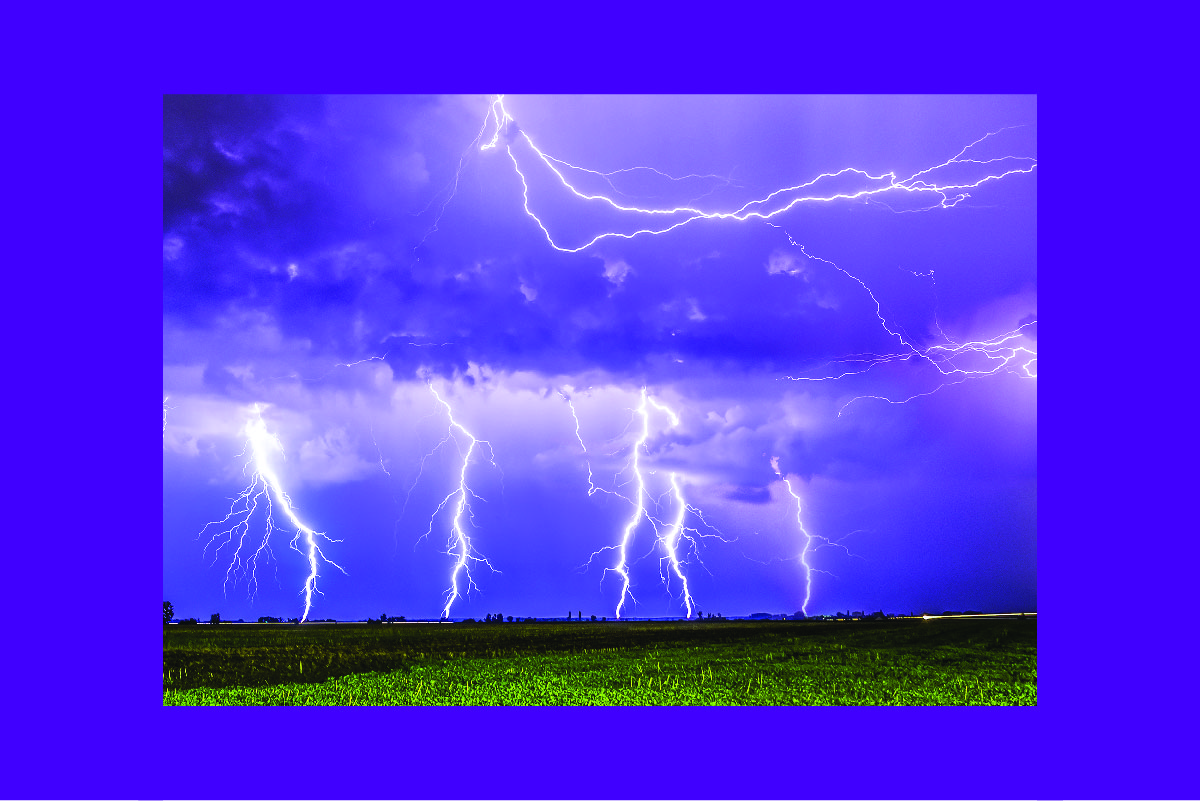

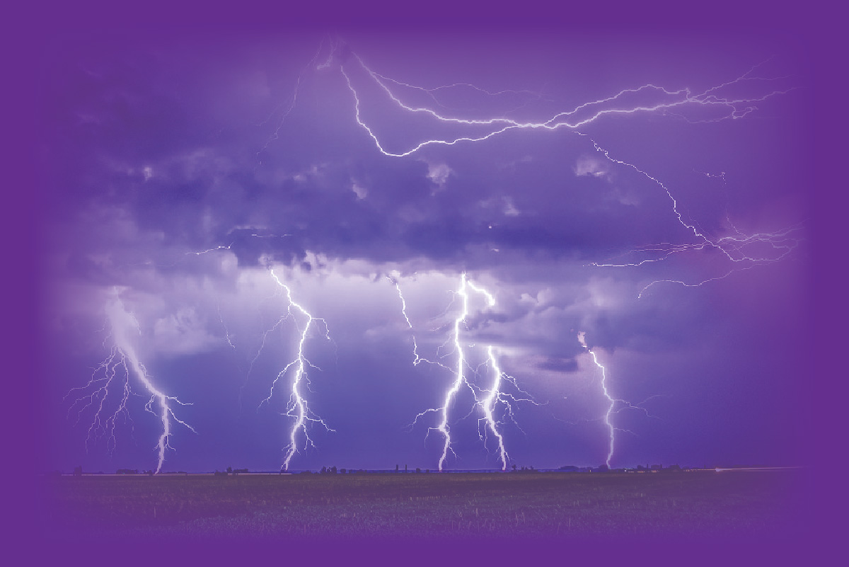

In the attached example there is a purple border around a JPG. Is there a way to make the border gradually fade into the picture on the inside edge of the border. Want the outside edge to remain full opacity. I am guessing with a transparent gradient but if the border is all one shape is there a way?
Thanks in advance.

Use gradient meshes. You'll have to play with them a bit. Put points all around the edge of the picture and sample the color at the point in the picture that it is touching for each point.

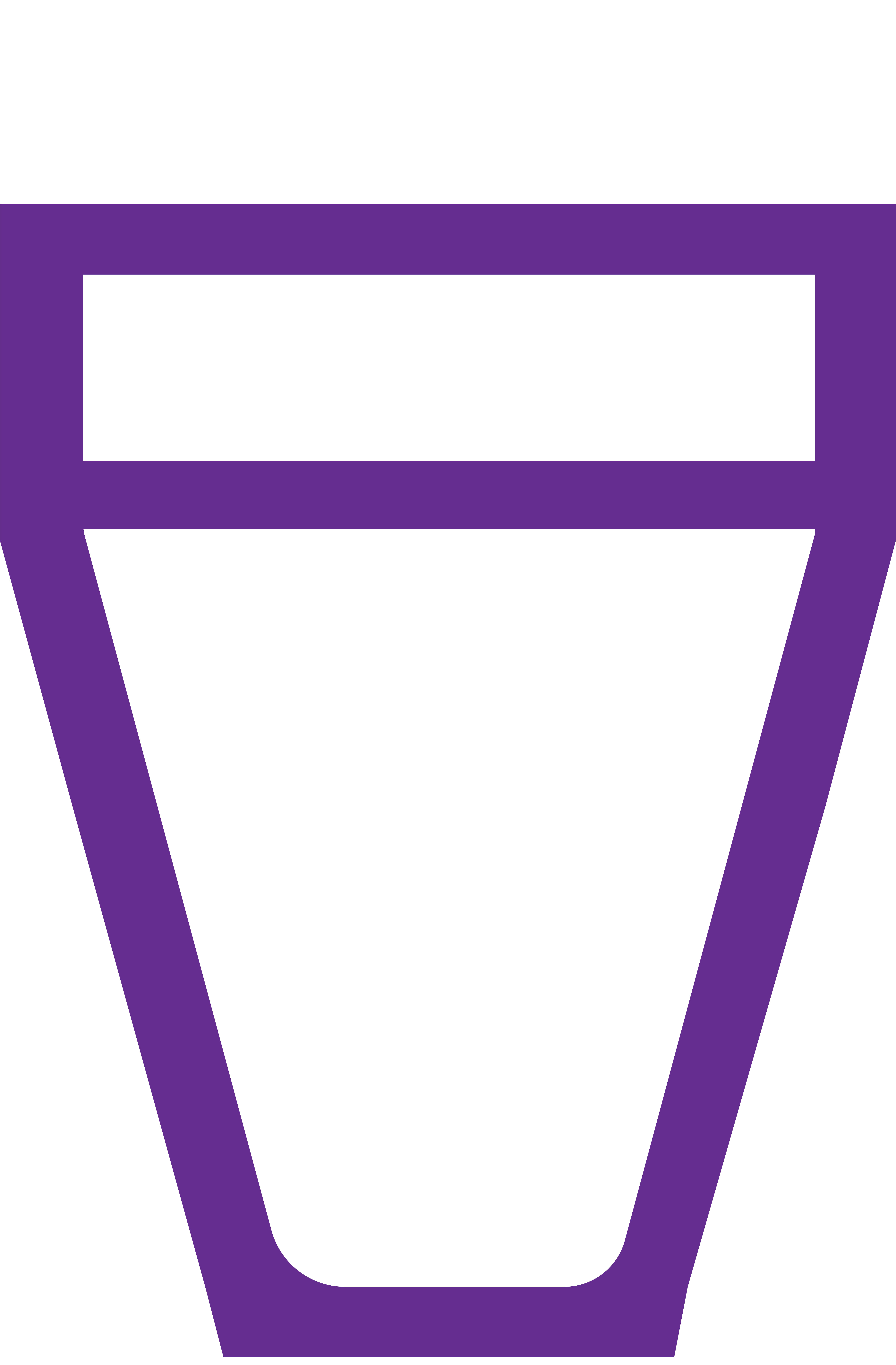

Yes both those example are what I am looking for but the shape is more complex than just a rectangle which complicates things. I just used the rectangle as a example. Attached is the clients shape. The bottom trapezoid will have a picture behind it showing in the white area. I need the inside edge of the purple to fade to the jpg behind it. Its all one shape at this point.

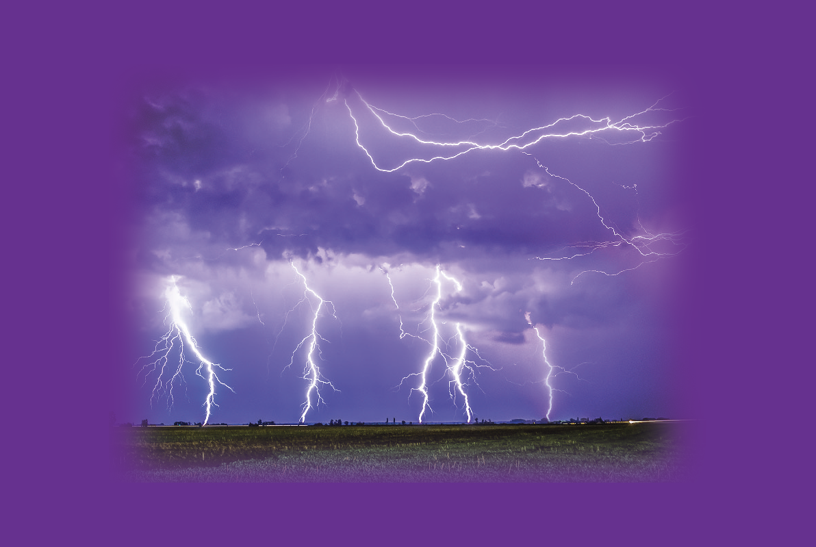

I would place the photo onto a purple box. Then select the photo and then choose Effect / Stylize / Feather. You can then Object / Rasterize and choose Transparent background.

View attachment 132937 I would place the photo onto a purple box. Then select the photo and then choose Effect / Stylize / Feather. You can then Object / Rasterize and choose Transparent background.
Well played, I didn't even remotely think about that, you don't even have to rasterize with transparency, it worked fine without it... and it works on odd shapes too...
