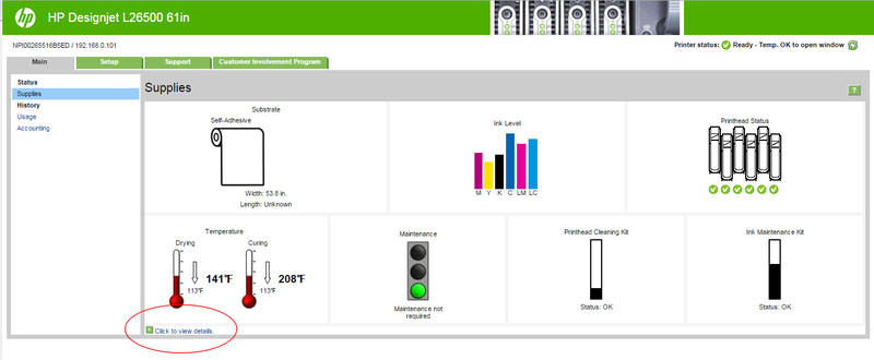

Mind asking him how I can find the Service Maintenance Kit life remaining? There is a user maintenance kit, which is the bin in front of the printer. But there are also 3 SERVICE maintenance kits which they don't tell you about when buying the printer that involve having a tech replace a bunch of stuff, and is not covered under warranty.
Not sure if yours is the same, but Web access for 260 looks like this...click down at the bottom and the Maintenance Kit usages are at the bottom of that page.
