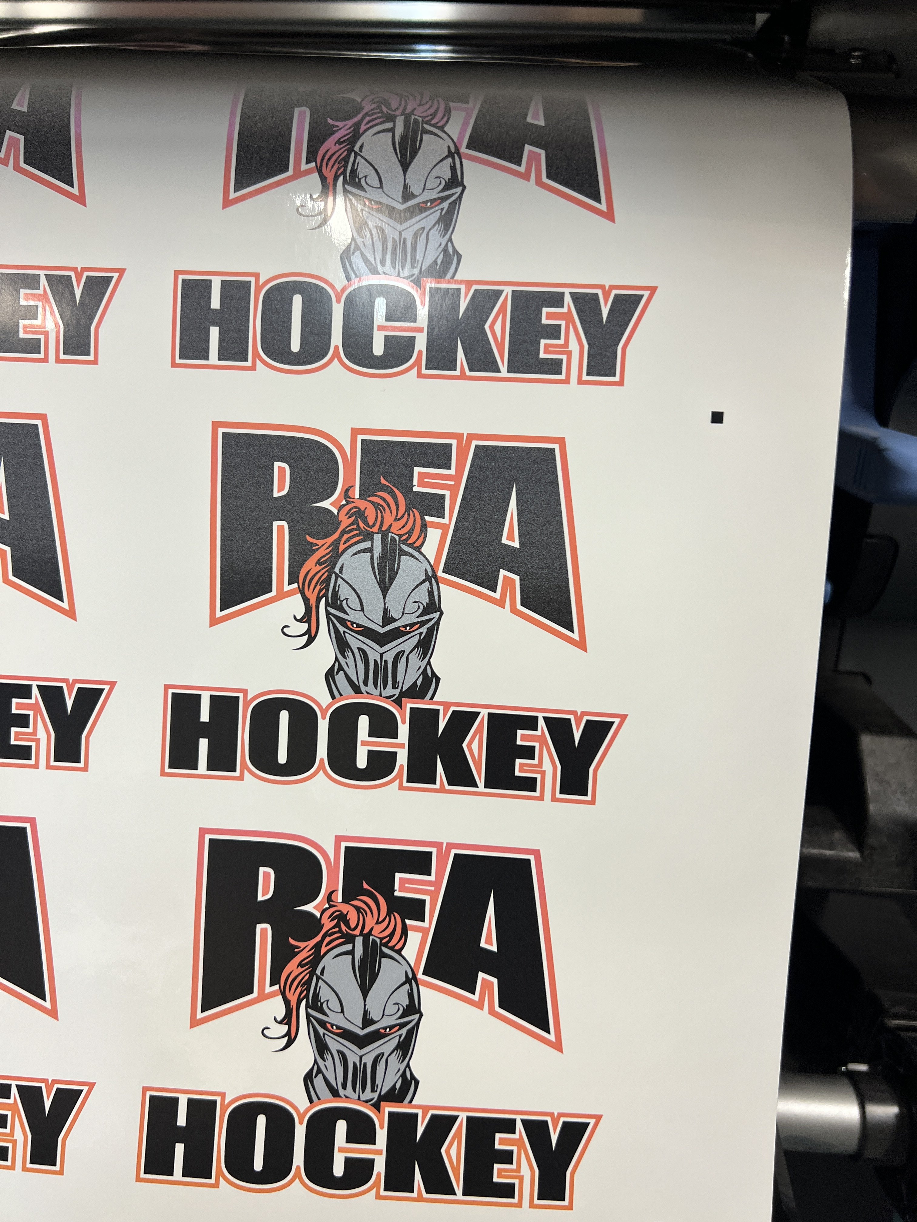

I am running a new to me HP315 with less than a 1000k sqm run through it using Flexi 22 print and cut. I have been running tests to make sure it's printing the colors I need with the appropriate profile. Printed one row of decals on calendared vinyl and that came out perfect. Continued on and went to print a set of 20 decals so 4 rows in total and after the first row the print quality seems to change. I have tried differed profiles which has not helped. Any input would be appreciated.

What media? What heater settings? If media is older, wipe area with alcohol, mark with sharpie and print see if the cleaned area prints better. If so bag the roll for a new one.
If temps of profile are set high, and printing in a cooler room, the heaters may not be keeping up with prepping media.
Set your adhesive vinyl profile temp to 214-215 degrees reprint. Most profiles default at 230 degrees…way too high

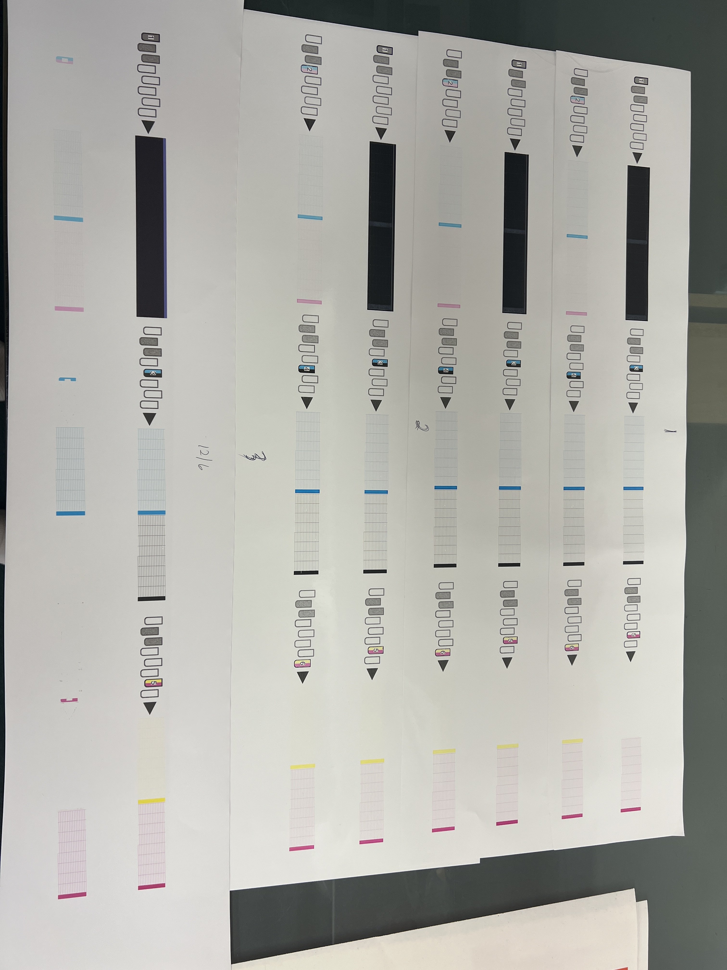

Hard to see but either one of your printheads drop out or your media is bad. I think the first one.
What's odd is the first three head checks showed just the magenta on head 5 was not printing. Replaced that with a new head and was good as you can see from the two follow up head checks. When the problem started today you can see that head 2 & 6 are out for some reason but they were fine on previous head checks. Hope this helps.

As far as media I tried a roll of cast and calendared vinyl and both are doing the same thing. As far as temps one profile had the temp at 240 and the other I tried was a 201. The room is at a constant 65 degrees with 40-60% humidity.

Hard to say what is the root cause but it's printheads anyway. Could also be dirty connections, problems with carriage PCA, trailing cable, somehow air in the line (pip covers get stuck easily) etc..

Well after replacing two heads the printer is working well and colors have much more pop. Thanks for the help.
