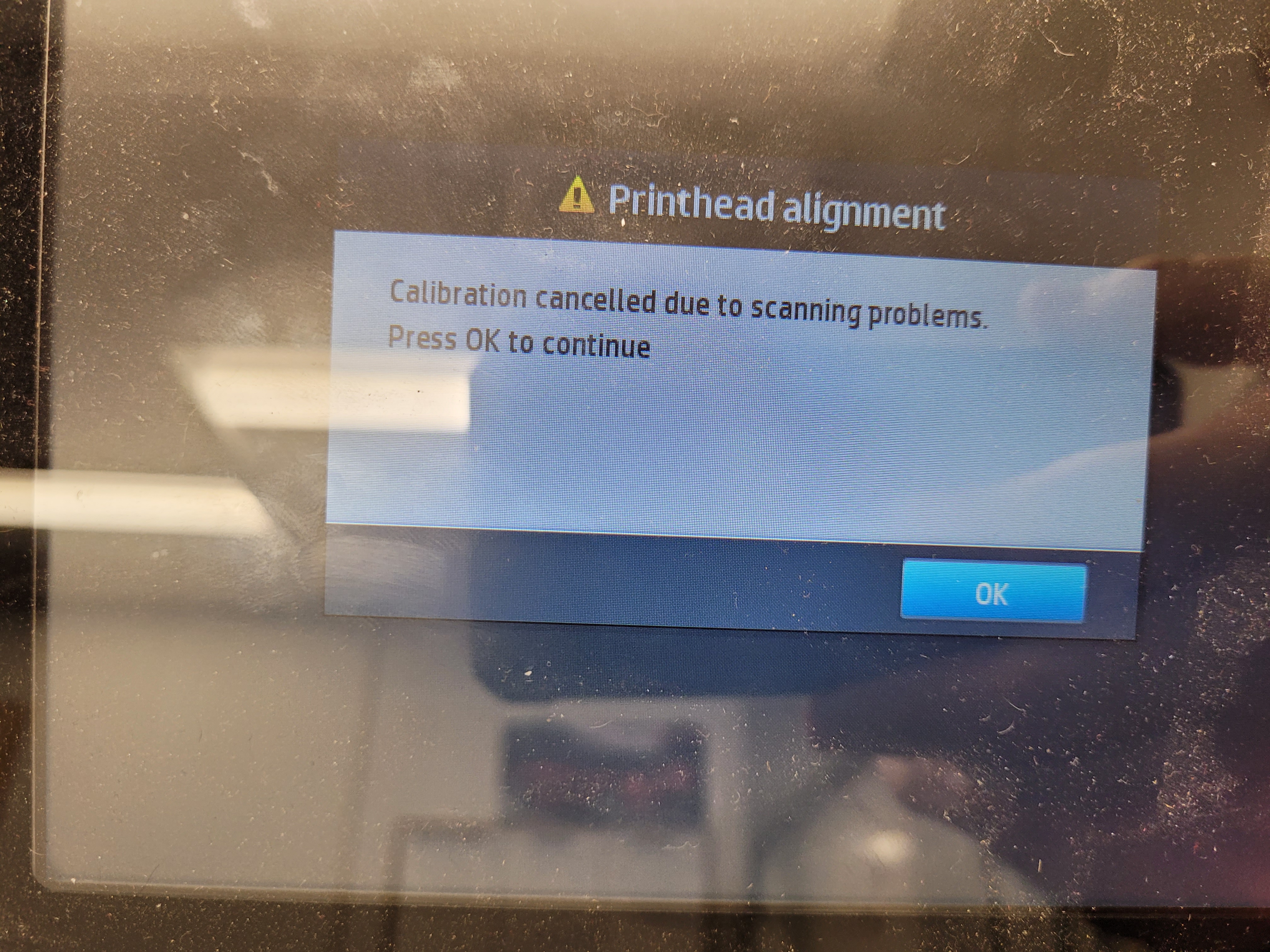

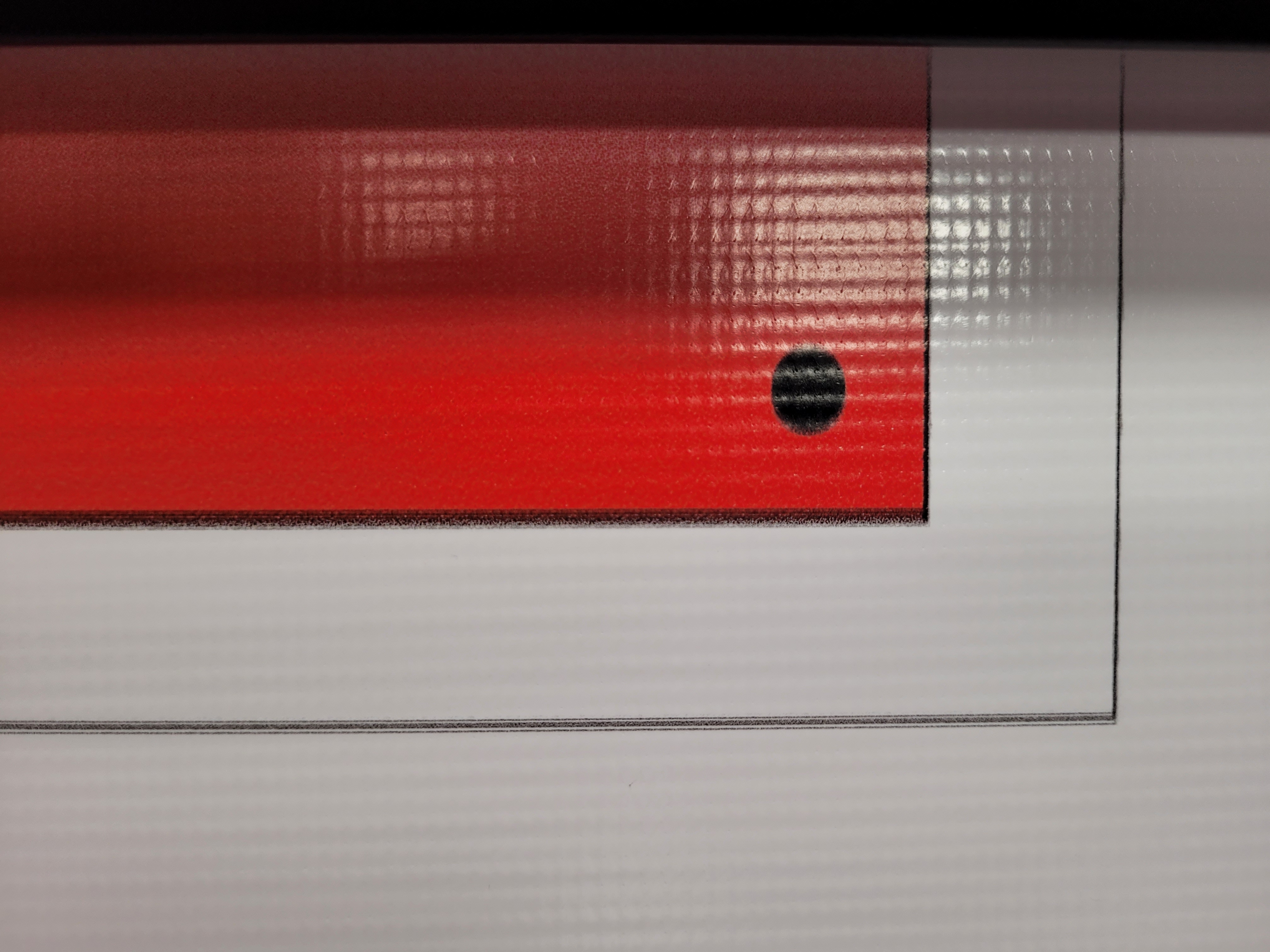

I having trouble printing a banner. It looks like the Y-axis is misaligned ( at least I think that is the y axis). I am also getting this error when i try to do an alignment.

Make sure that you are running the PH Alignment on glossy self-adhesive vinyl for best results.
You can also run a plot to adjust PHs manually in the event that the sensor is dirty or has an issue.

I think you have feed issues but whatever.
Make sure your line sensor is working as it should and encoder is clean. Make sure printheads are in good condition or it can't read the adjustments.
OR do manual alingment.
