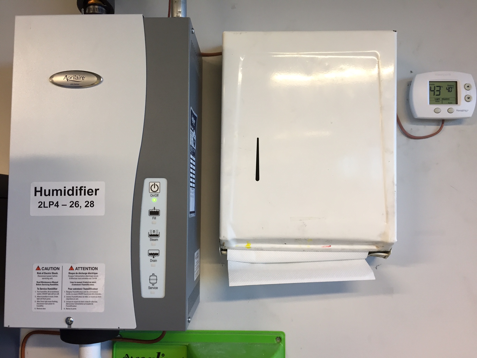

Humidity in KS was running about 10% during the winter and we had issues as everyone else does with static and overspray due to the ambient environmental conditions. Our demo room is about 2300 square feet with 15' ceilings and we added a Aprilaire 800 series steam humidifier, which cured that problem. If anyone is looking for an industrial solution from their local HVAC guy i would highly recommend it (see attached)
