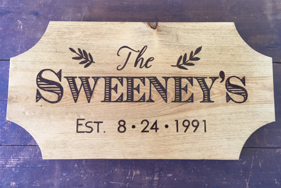

...let me get it right........you want to make a OUTDOOR SIGN, with BURNT IN LETTERS??? ok if that is you end product, real simple.
YOU BEEN BURNING WOOD for a while you say, SOOOOOOOOO whats the best plain wood you can use???? PLYWOOD IS NO OPTION HERE!!!
clear pine or cedar would be my 1st choice. oak, walnut if your for some thing classy. you dont give a size......of the sign. so iam going to assume its not more the 12" tall. as 1 X 12 clear pine is as big as a single board you can by. if its 24" you will have to edge glue 2 - 1 X 12's. now thatis a whole other process.
lets stay with a 1" or 2" thick pine. now the clear pine is yellow white.......your burning of the letters are going to be dark brown, almost black.
Make a pattern of the letters on paper......can be done on single std letter paper. depending on your printer i have 13 x 19......and i have a plotter i can draw the letters on a roll of paper.......trace the back the letter, lay it on the board, with a good hard pencil( google carpenters pencil) draw over the letters. burn the letters.
ME...... i would CLEAR COAT 4-5 COATS..... and it will last 5-6 years for sure.
