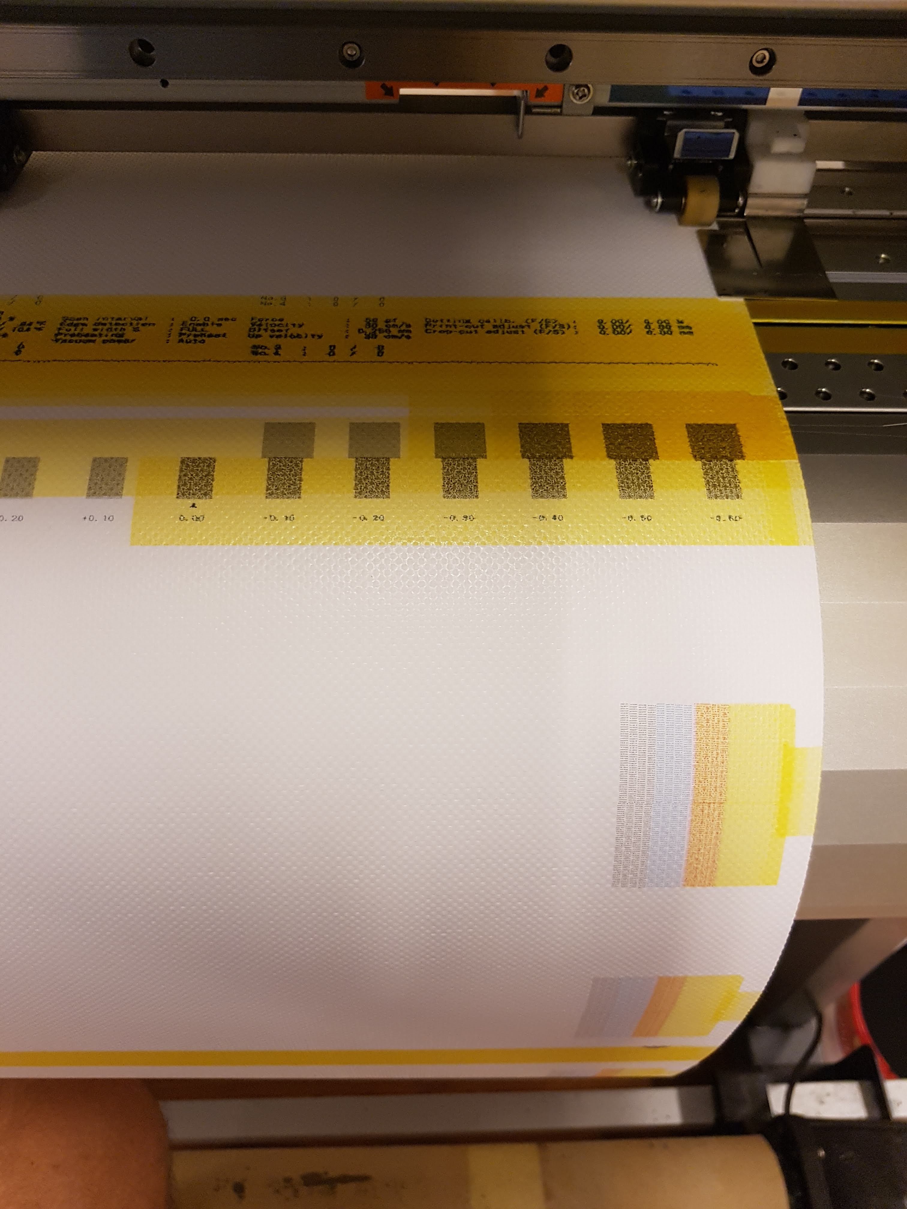

Does anyone know why yellow ink floods any printing I do? I'd just completed 2 jobs with great results and then the very next day the yellow starts flooding the media as you can see in the attached JPG.
Anyone else had this issue before?
Just completed replacing the cyan/black printhead and all dampers were replaced, too.
Hope someone can help!

There is a short circuit in a printhead or in a PH cables or just a connection issue between PH-cables-carriage board

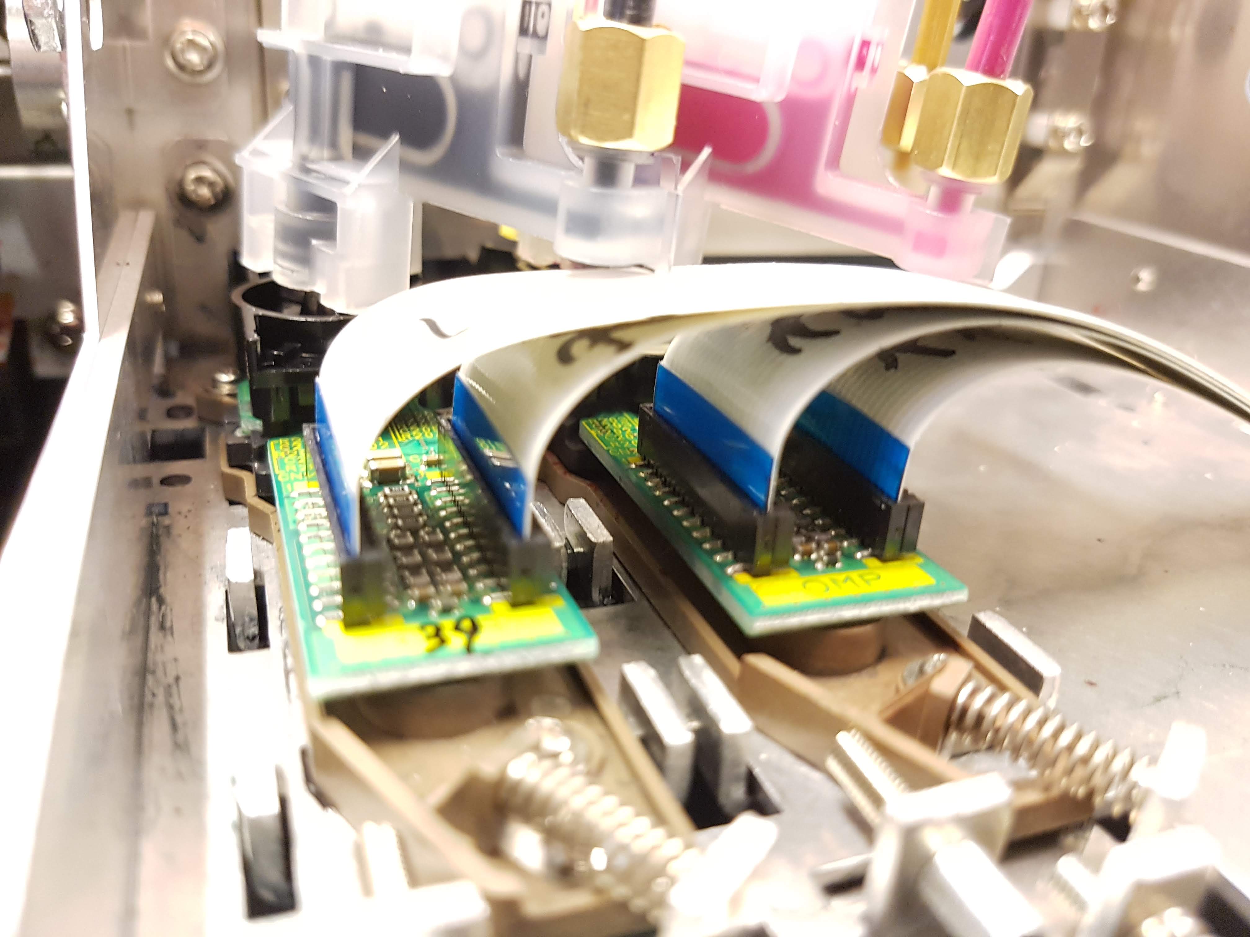

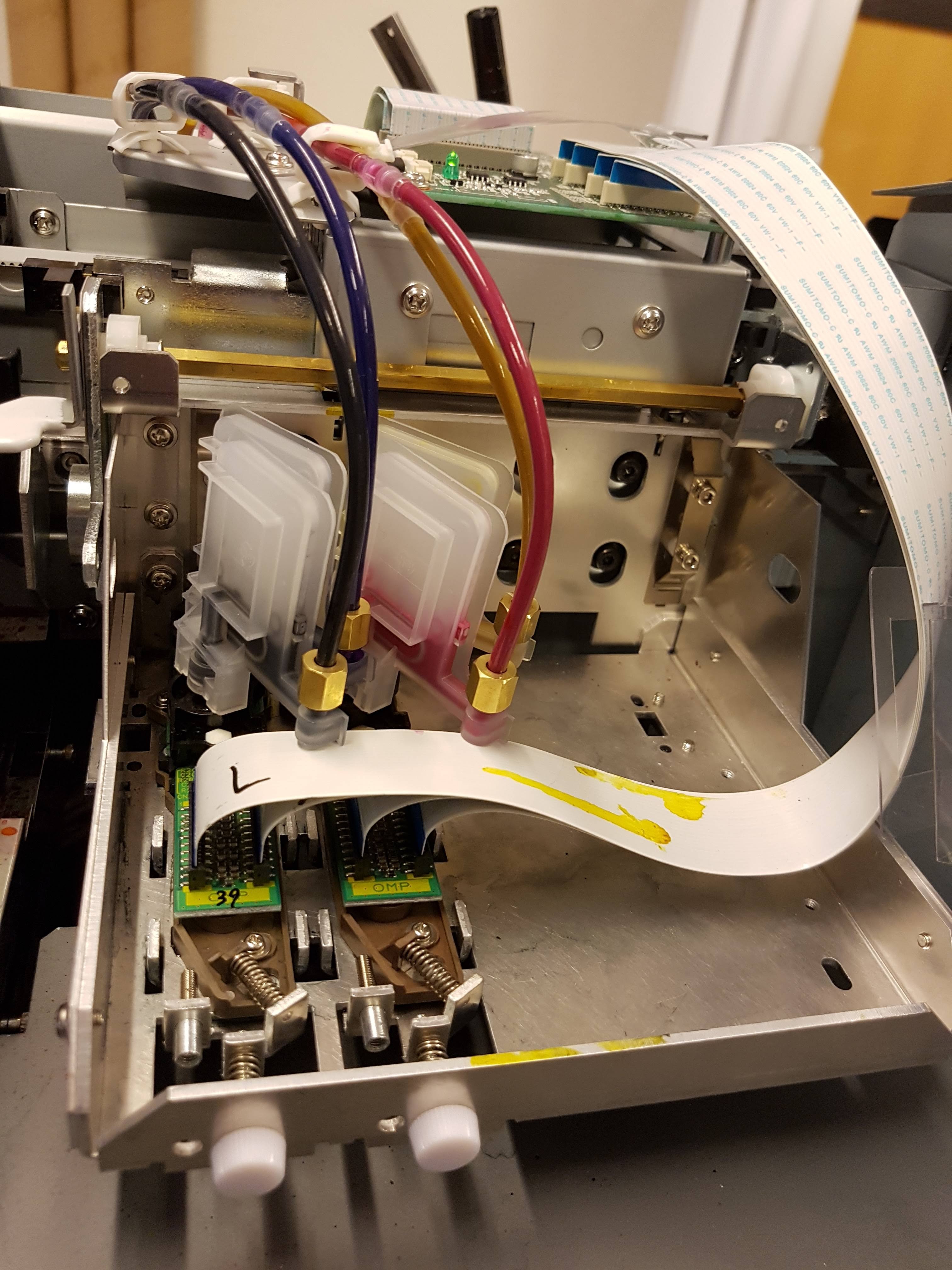

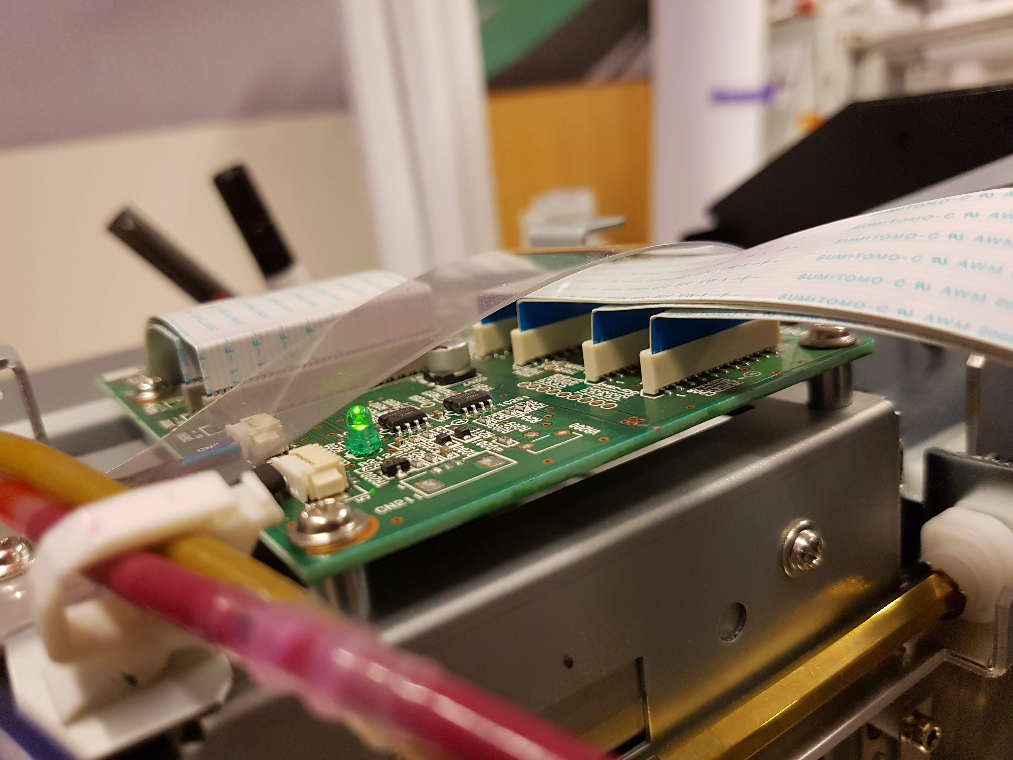

Thanks for the reply. That seems to be where the issue is, but I have tried reattaching the cable many times without any change. Everything looks good (see attached). Could the PH cable itself be faulty?

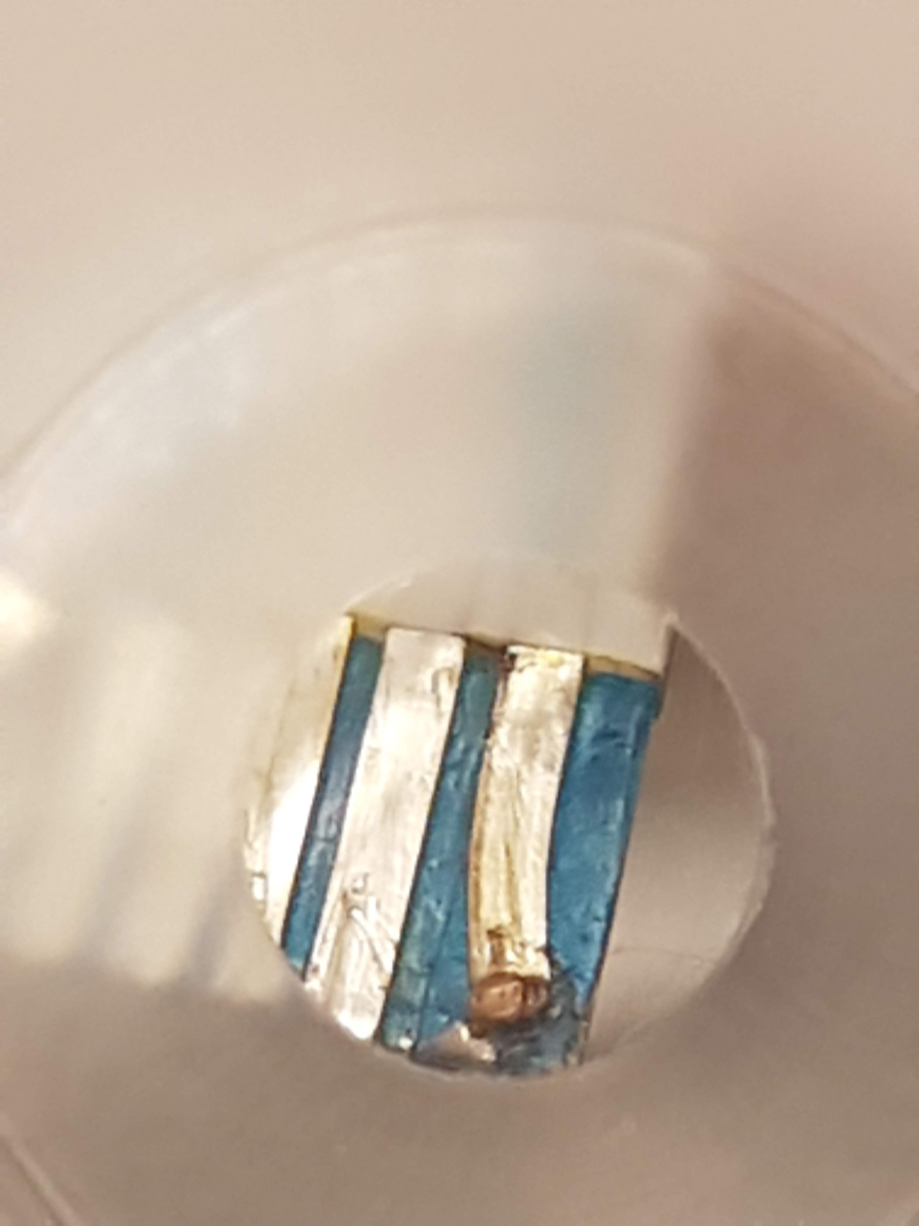

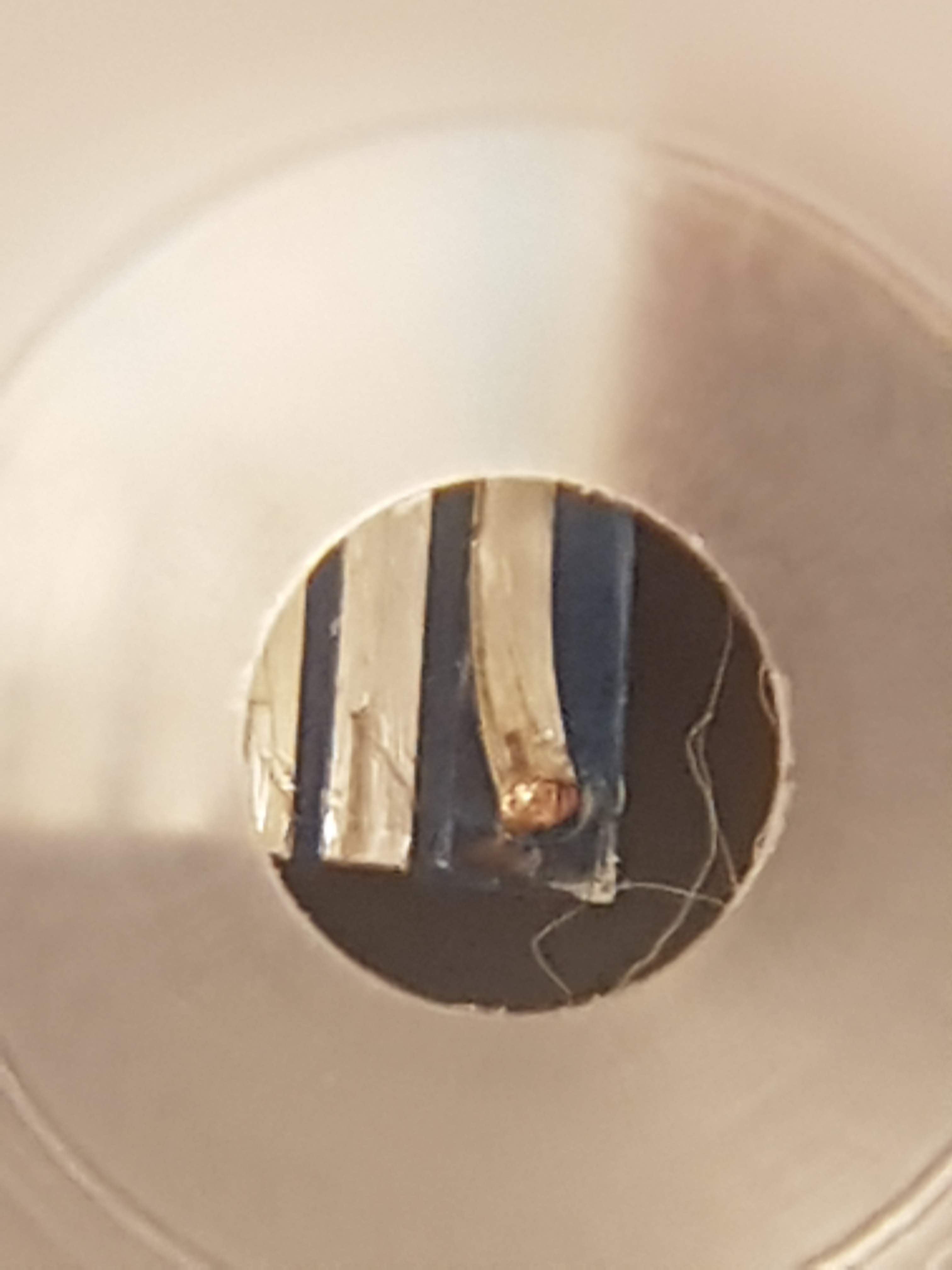

There is a bit of damage on the one contact as yopu can see here. Could it be that?

Could it be that?
Can't say that it's good for you but i doesnt look as a big proble though.
Try following. Remove the Y-channel cable and insert the K-channel cable from the Car.Bor. to the Y-channel PH. Then try to print just K square. We'll see then.
