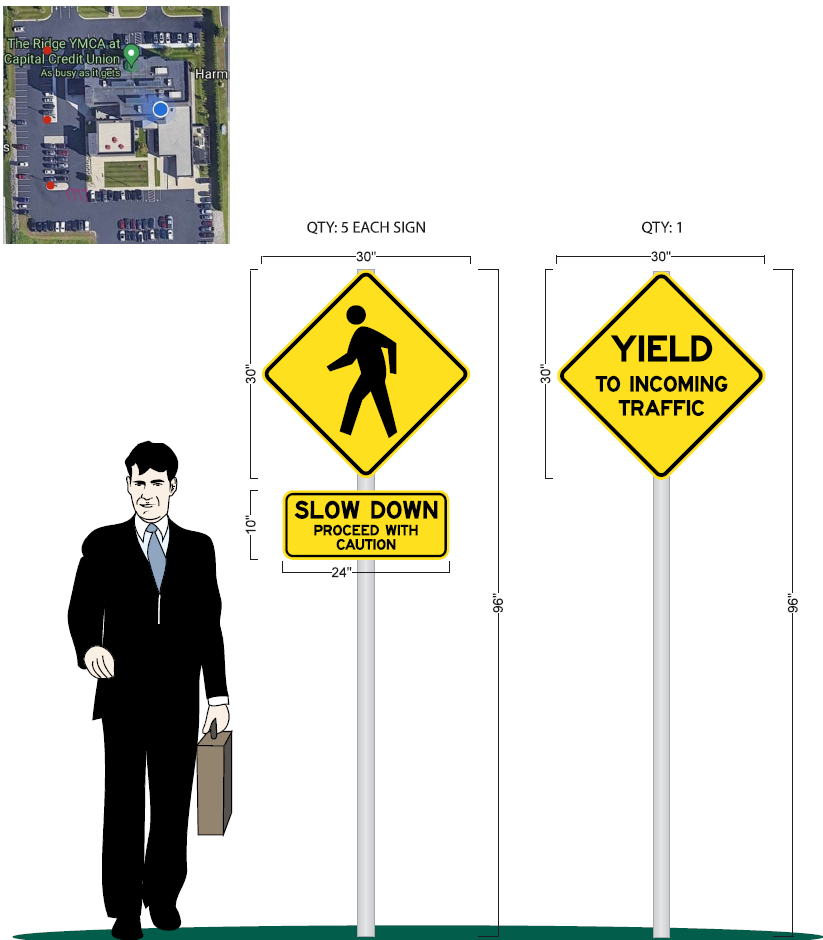

I have a customer looking to have 5 double sided traffic posts installed in their parking lot. We print the signs ourselves, reflective vinyl on aluminum, but I've never installed the post portion one. I was looking at Grimco and saw their square posts as the base, but I didn't see any mounting equipment for putting 2 signs on there. Has anyone done something like this?

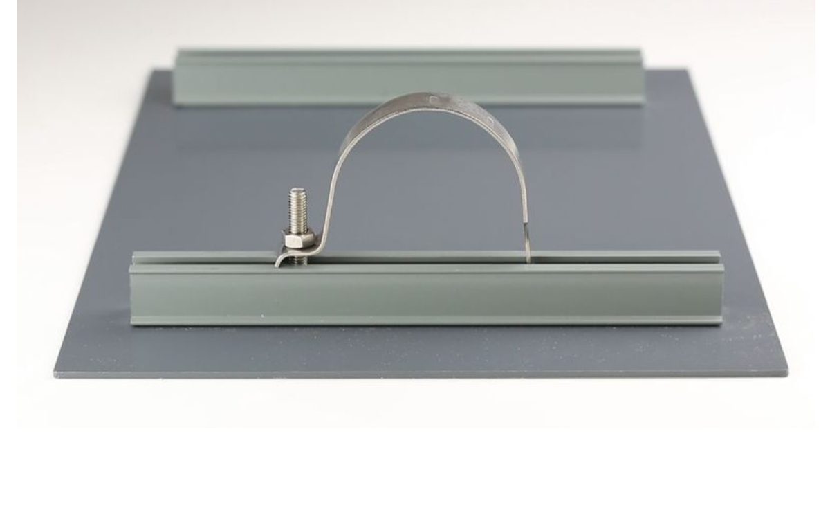

Not sure if these are made differently in the U.S. in the U.K. this would achieved with channel fitted to the rear of the panel and post clips
MrDav3C
Something like the attached (square clips are also available) obviously if it's double sided make sure to have the channel at slightly different heights so the clips don't won't foul up on each other.
