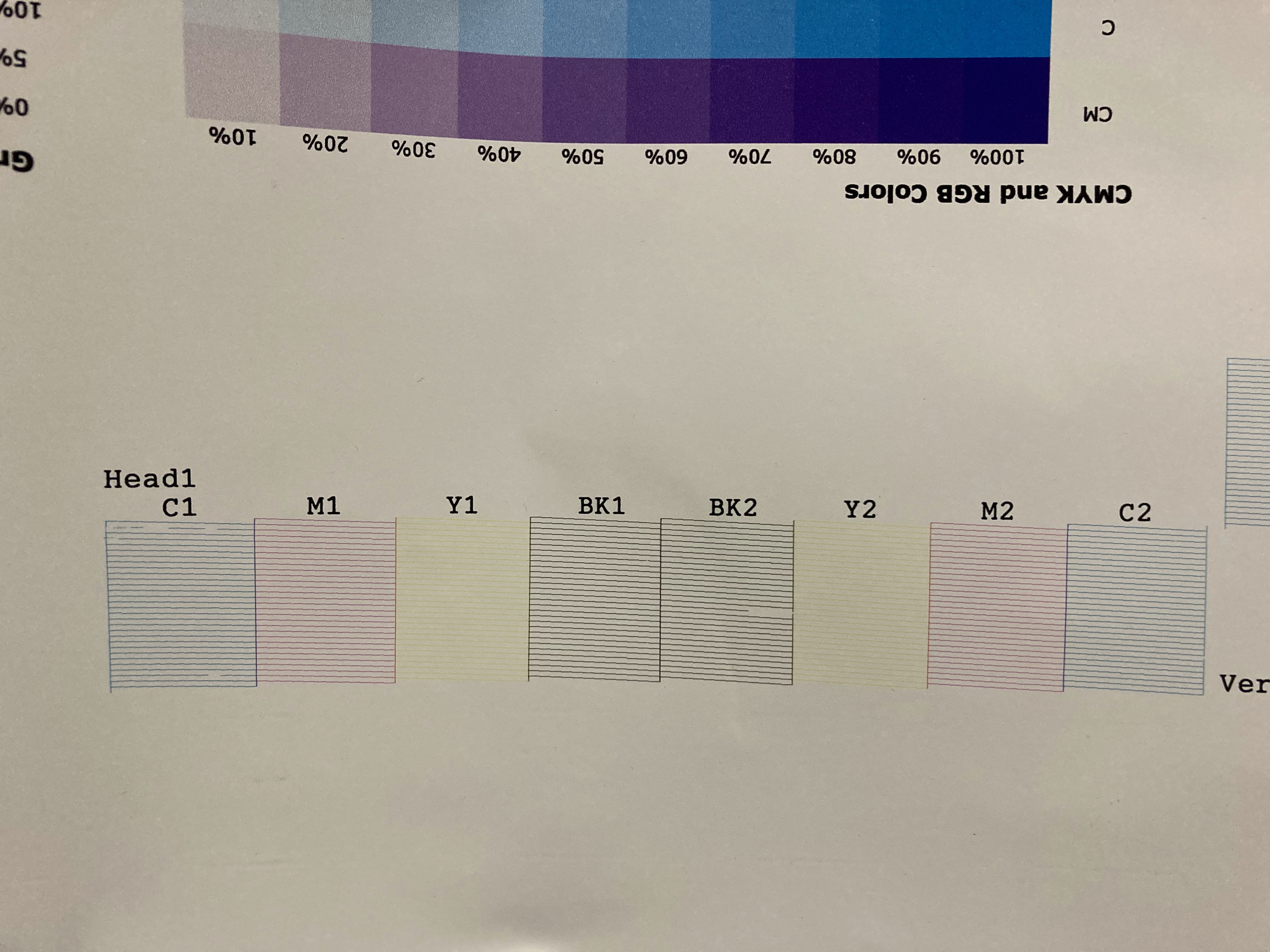

There is business that closed selling a Epson SureColor S60600 , hoping someone can give me some tips as to what to look for, and is there a report I can print to give me an idea of printer history. The seller is asking $6,000, but is taking offers.

Very little that goes wrong on these machines (apart from current ink supply issues in some areas).
Get a current nozzle test and check that it's clean. In 3.5 years our S80600 still has zero deflections and we've just had our first nozzle go bad over the Xmas break, but impossible to notice in any print even down to 4 pass.

Thank you all for the replies.
