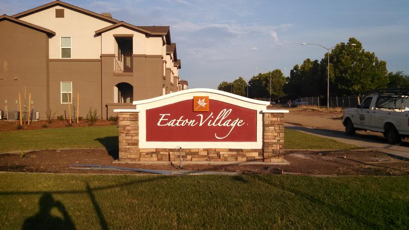

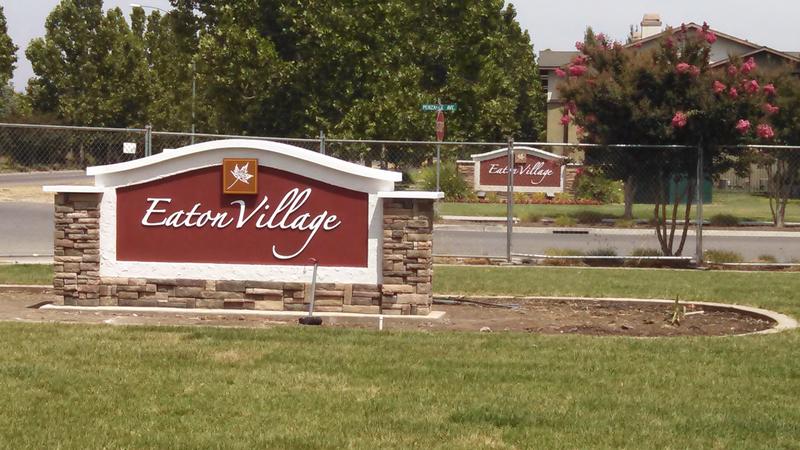

Just completed a monument sign for 'phase 2' of a large apartment community - we did the phase 1 sign 10 years ago, and was asked to mirror it on the other side of the entrance.
Aluminum construction, foam buildouts, then stucco texture
PVC lettering, 2" thick v-carved and 'boxed' ACM emblem
HDU caps (layered on-site out of 1 inch HDU - top cap is 3", sides are 2" thick)
cultured stone base and pillars
