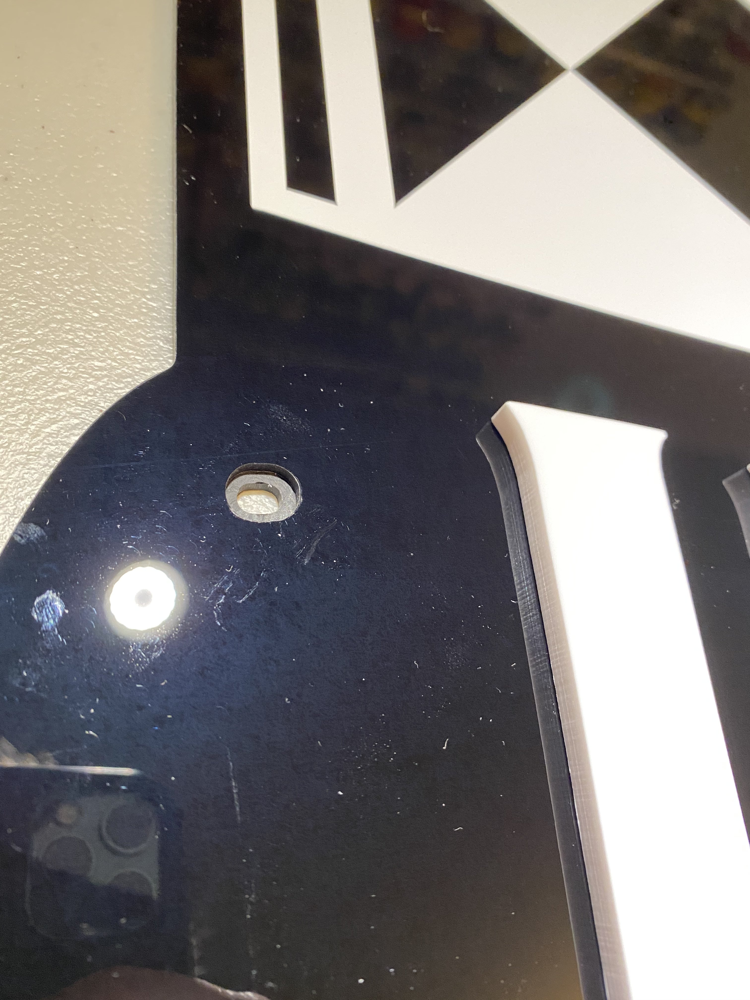

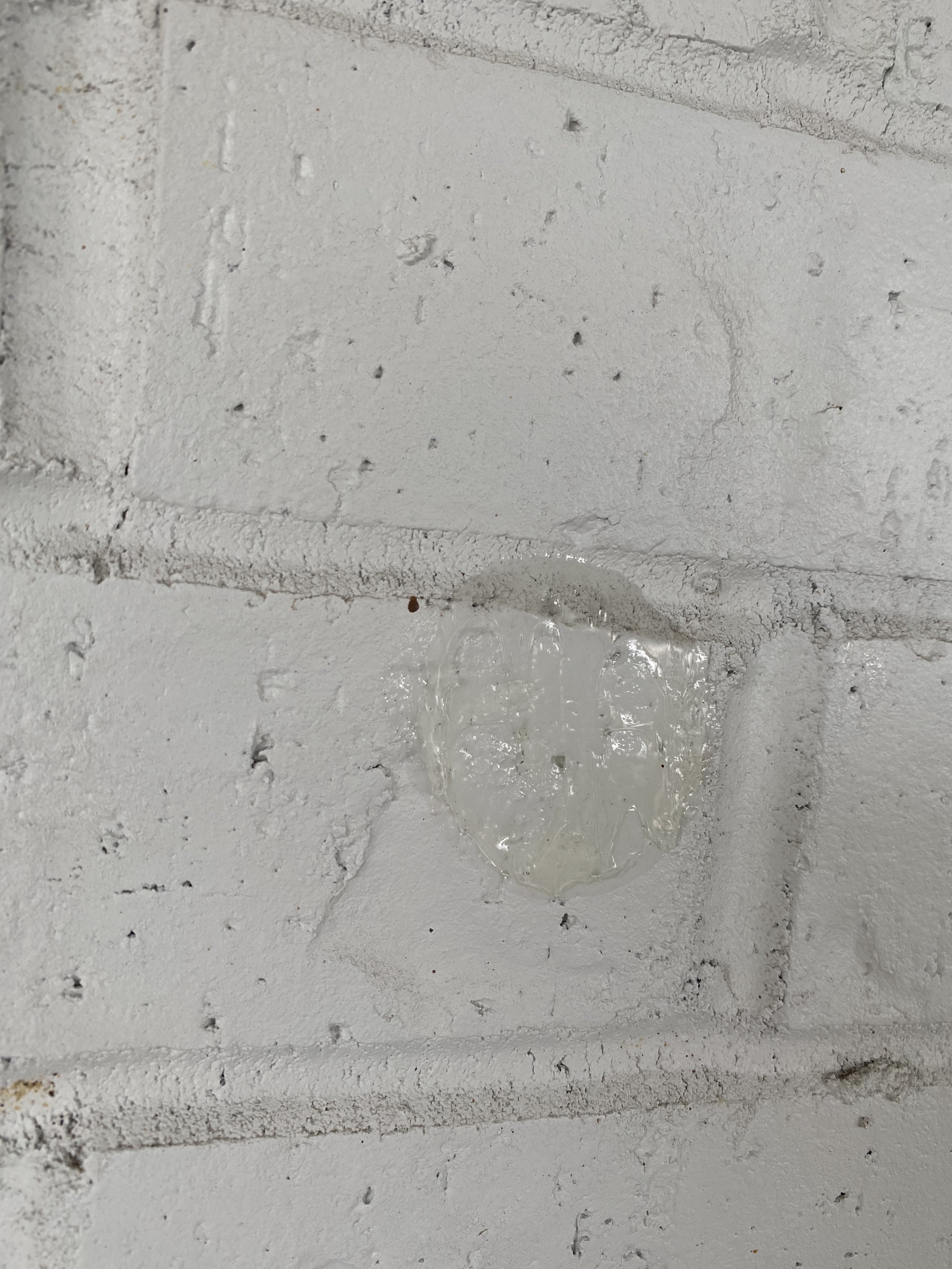

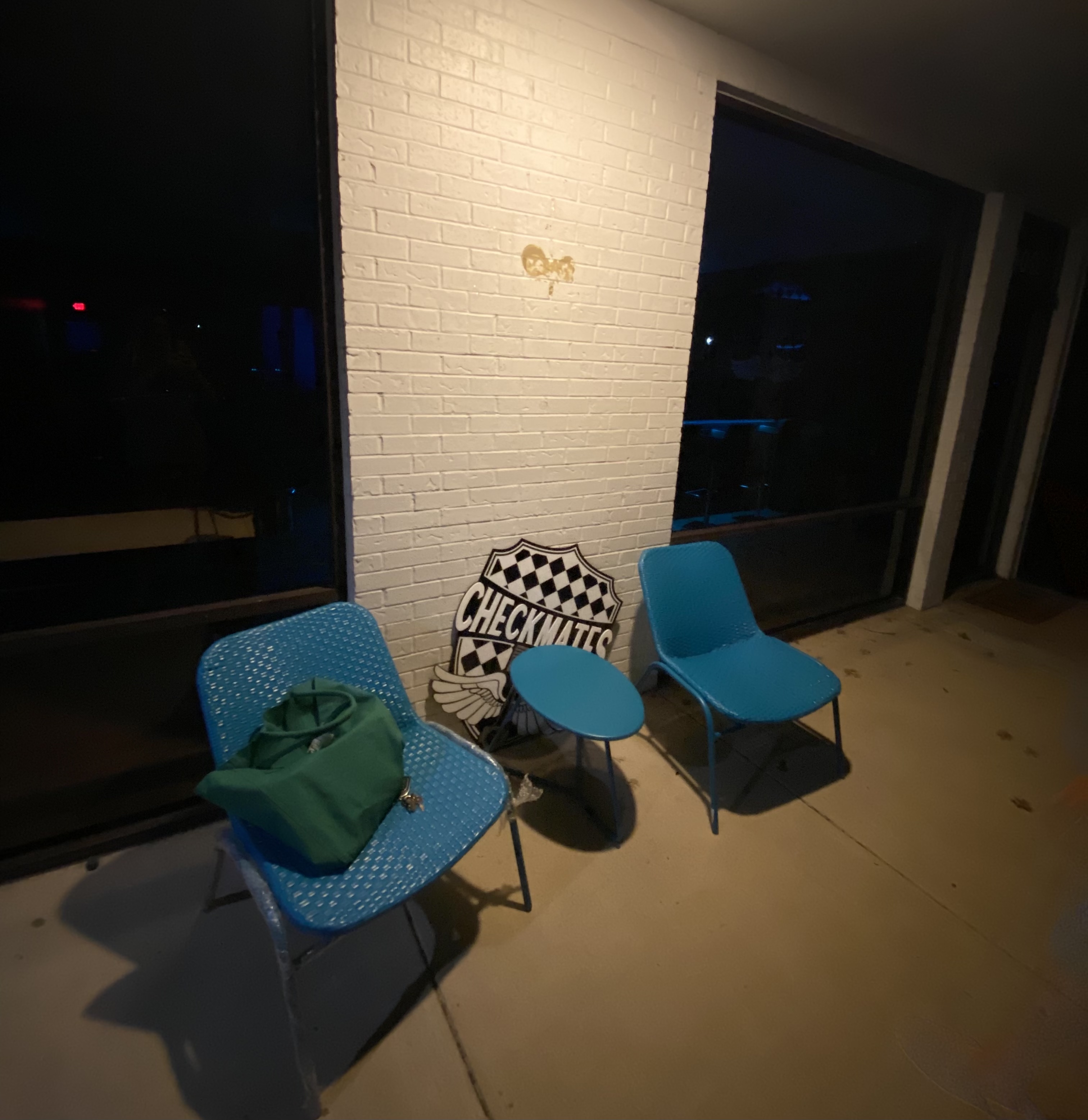

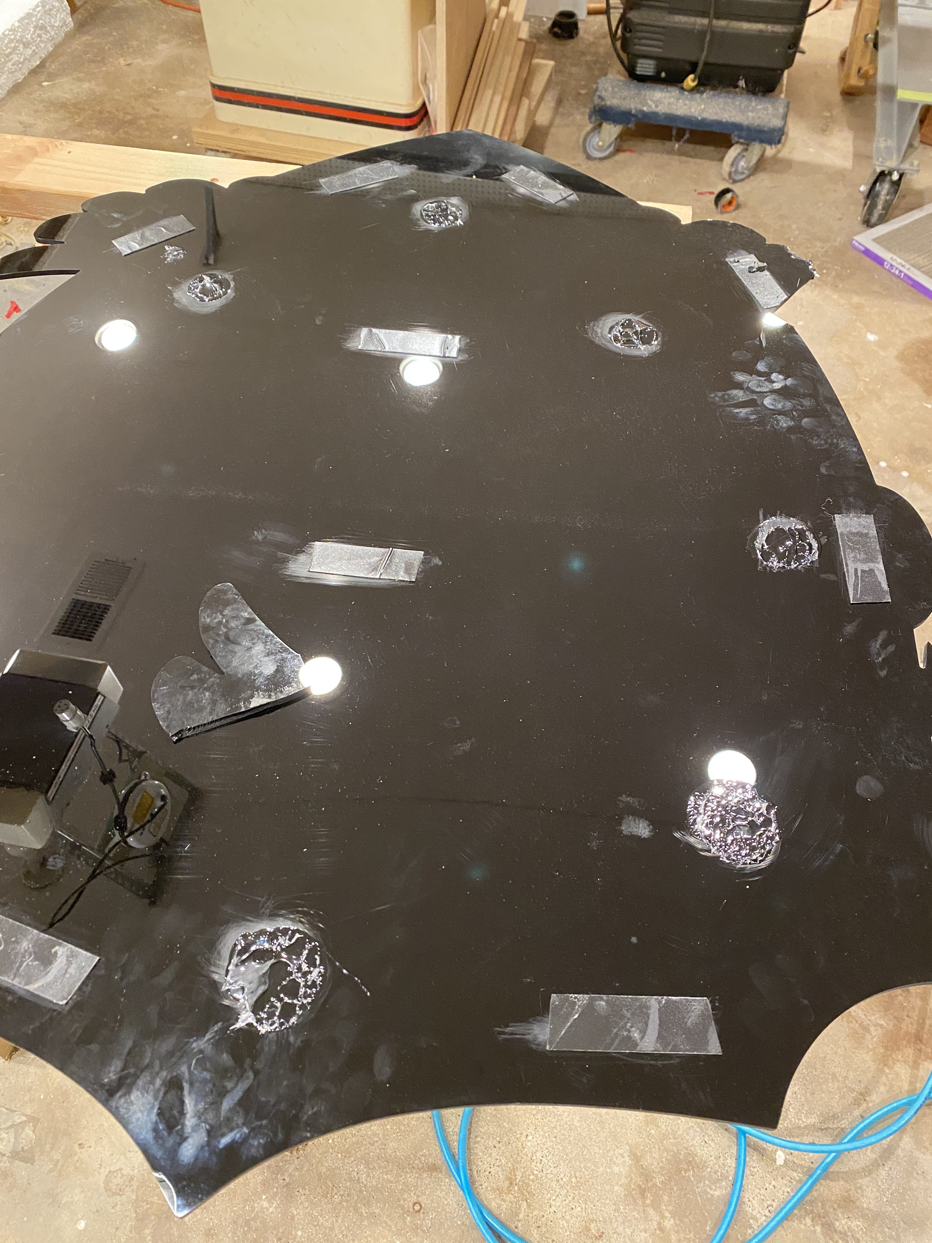

Well, can’t win them all I guess. Got a text the day after install.... the sign is on the ground shattered. I have used lexel and vhb on other signage in this same complex with no issue but never anything this large. The brick was a little extra uneven here. Lexel stuck great to acrylic and painted brick, guess the vhb just didn’t hold long enough for it to set all the way (liquid nail stain is from old sign). Remember reading someone using Lexel, vhb and loctite power grab together. Anyway, the redo is getting some screws hidden behind three of the acrylic letters! Lesson learned, Lexel says full cure can take 1-2 weeks, guess they aren’t kidding. Any experience how long it usually takes to grab?

Shame, that looks like a very nice piece of work. JMO, not near enough adhesive or tape for that application. Maybe a nice thin french cleat instead?

At a minimum, I would run long strips of that tape and long beads of Lexel... not splotchy like that. It might take a roll of tape and half a thing of Lexel but that is cheaper than replacing sign. Studs are preferred
