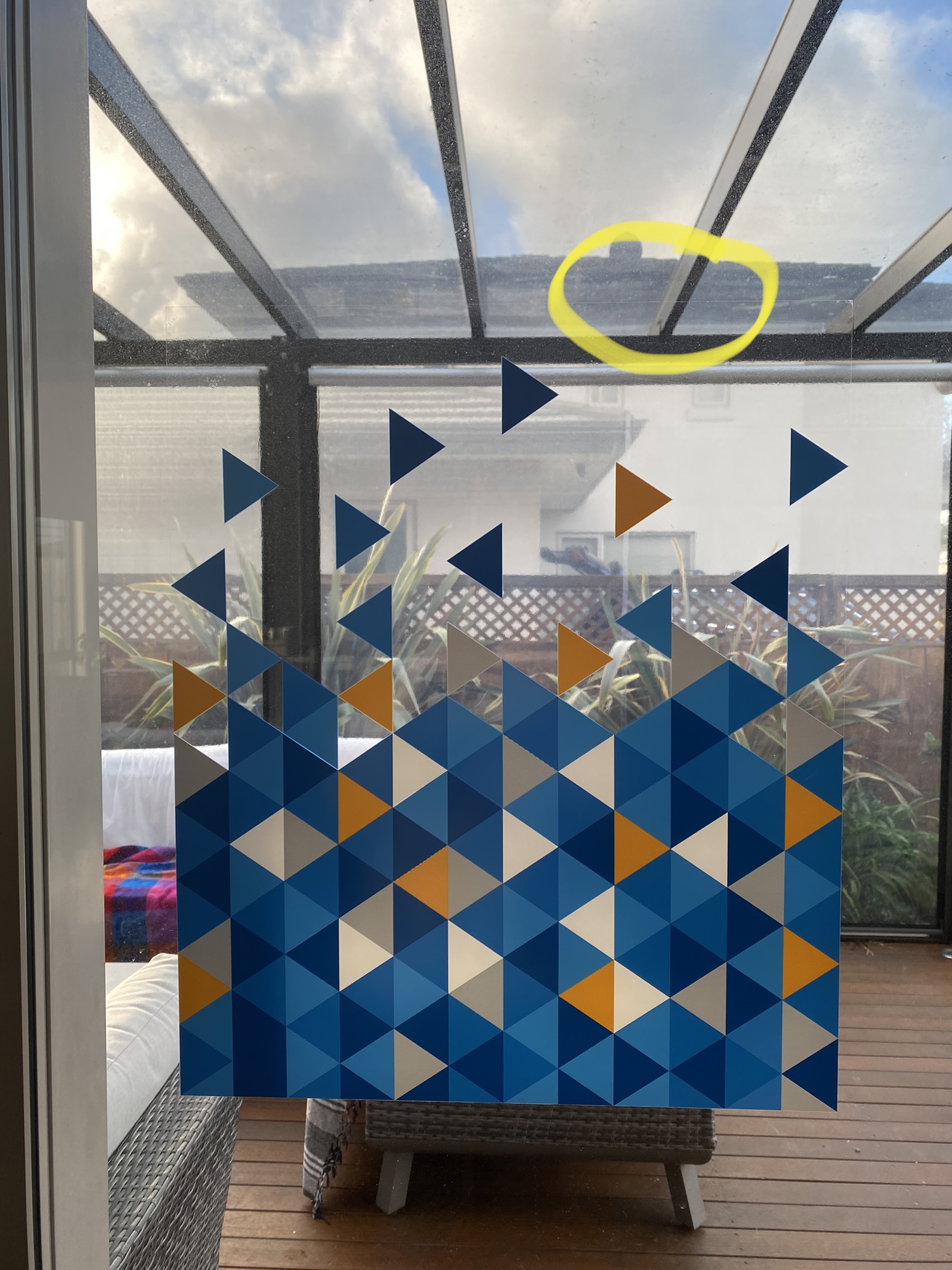

It prints beautifully, is easy to install, is ultra-clear (can't even see the edges when it's on the window) but I need it to last 2-3 years as am offering images for peoples shower screens (on the outside of course)
I ask because I currently print on Image Perfect IP2930 and self-laminate but this leaves a heavy edge when I want to computer cut shapes - particularly circles
Love some insight from others.
I've attached two photos showing the edges. The Macaw is printed on IP3920 and laminated. The Triangles is printed on LP3962 No lamination
