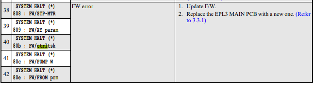

Might need a tech to reflash firmware or parameters. Lack the manual for the TX300P-1800, but checked the error for the TS300-1800P. Not quite the same printer however.
