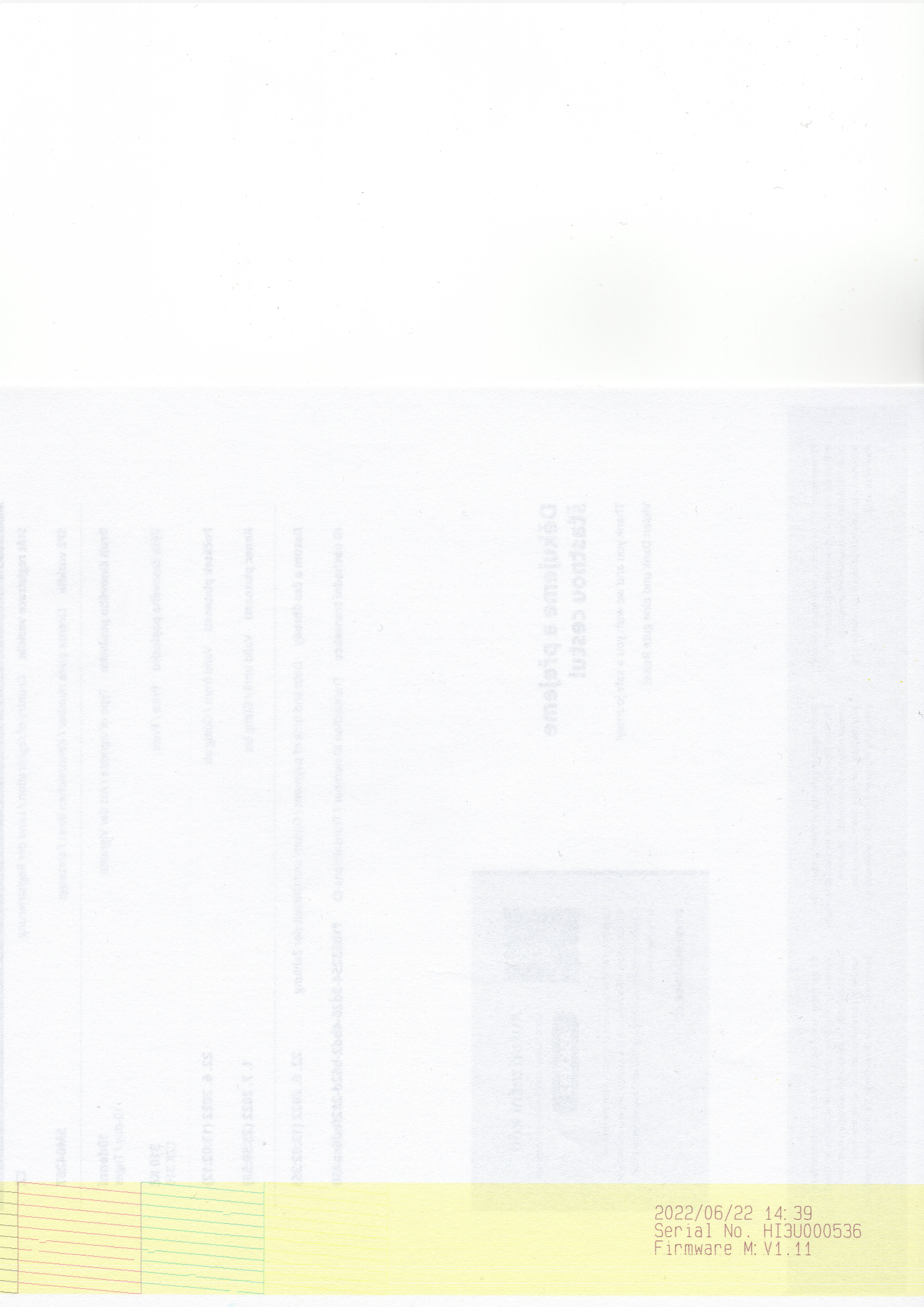

Hey guys,
I've getting annoyed on and on. Last time, I've problem with leaking head. It's about year ago. It's at least 12 months and there you go... another problem. I've yellow color band over printarea. Did anyone has these issues on Valuejets? Yeah, it's 100% electrical problem. I've disconnected ribbons from head to CR board. Cables were dirty, so I cleaned it with isopropylalcohol, airbursted connectors...nothing happens. Still same problem. I dont know how to diagnose bad board or smth.
I must admit that I've recetly some electrical problems. The machine completely stuck, red diod appears. Only solid light, not blinking and machine did nothing. So, I've pressed big red button to power off and restart it. Machine run perfectly after this. I've had this kind of stuck once a month.
See attachment. Its normal test print, but completely yellow colored. It's not messy. It's like If I add yellow background in Illustrator.
unmateria
REPLACE the flat cables always...
Yes, i know, sounds stupid since they look good to you even with a microscope... But i have seen that so many times...
Ah, and clean inside the conectors with just isopropyl alcohol, dont use air on smd mounted PCBs (you will blow something or you will put water there).
