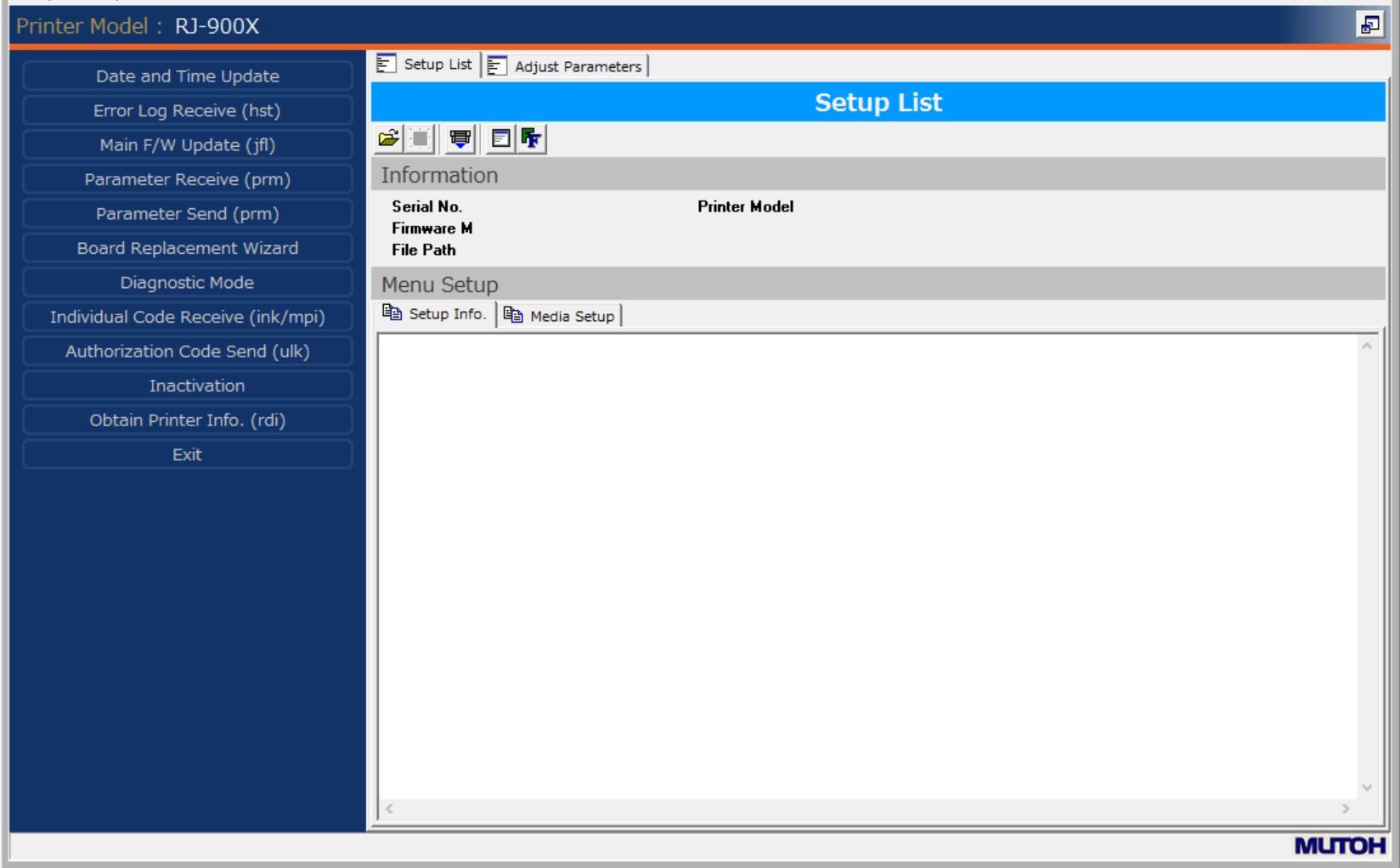

henryp
If you are in MSA Technician Mode, you should see this menu. You need to use the Board Replacement Wizard. What this program does is it will clone your original mainboard.
place4print
Thank you! I will try it tomorrow morning. I send you update about the process.
