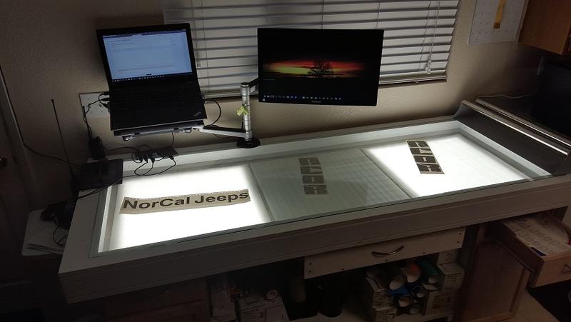

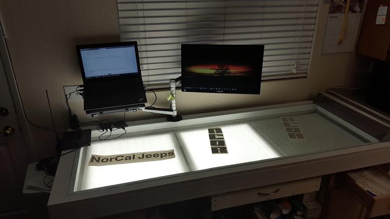

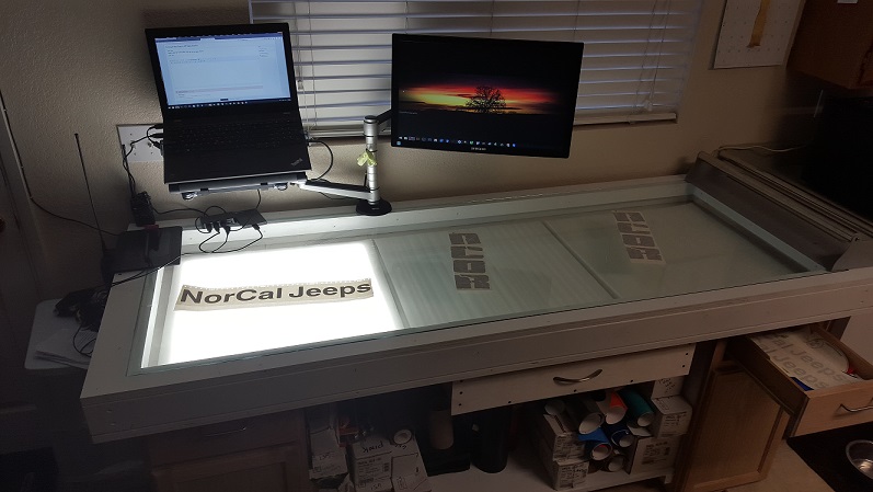

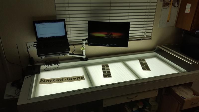

My new design table for my own specs of work i do
Pippin Decals
Still placing cables and cords out of the way when i took these pictures..The cable to the far left in the image runs over my door jam to my cutter that is plugged into a powered usb hub which allows me to run a very long usb cord with no loss of any info from my laptop to cutter,,,( I love that)........My design table for vinyl decals/graphics etc to my own specs of what i wanted for what i do..Over all size is 32"wx7 feet long...Usable working area is 25.5 "wide by 6 foot 1"...remote control led panels which are 5000k...And i added a app tape roller on the end with a laptop and lcd monitor in the back that allows me to design and move it all out of the way to work...

I like it, I wouldn't mind building something like that for myself. What did that cost you to make?
Pippin Decals
if i had to buy the glass it was about $872.00 for everything,,,,,,,, but that is very workable to get lower and save alot of money............the cabinets were from home depot.about $80.00 each...Lcd and monitor setup was 148.00 from office depot. Glass was a straight trade for doing business design for thre glass company i got it from, other wise 150.00 but i went over kill on the thinkness of 3/8. i was told i could use 1/4 but i didnt feel comfortable lol... i got 3/4 mdo paper covered for a steal at a lumber store to make my top and bottom for $15.00 and the size was 2 4 feet by 12 feet and just cut them down.( it was scrap) otherwise it runs like 25.00 a sheet of 4x8...i wanted the paper so i would have a smooth surface and painted white..about 4- 2x4's at about $3.00 each to make my sides and front/rear. 3 Led panels i got from a supplier here that ran $110.00 each, but home depot sells there own brand but they run 180 each. i didnt like them tho..You can get lucky and get used or returned cabinets from home depot etc. same with glass as scrap. the Led lights i would check around or look up the company called multi-lite.com( but i got them from the local rep so shop around around.. if you need any more info let me know and ill do my best to help out ...Thanks for compliments..Dwayne @ pippinphotograhpy.com
